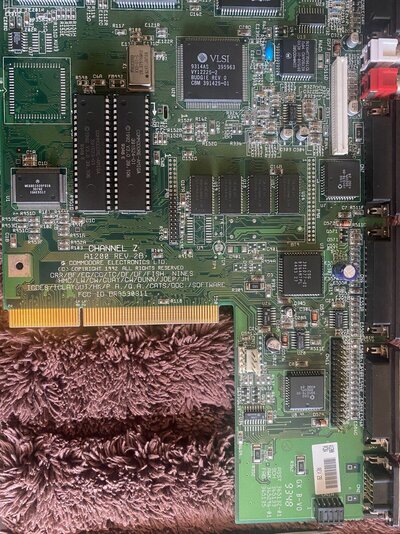

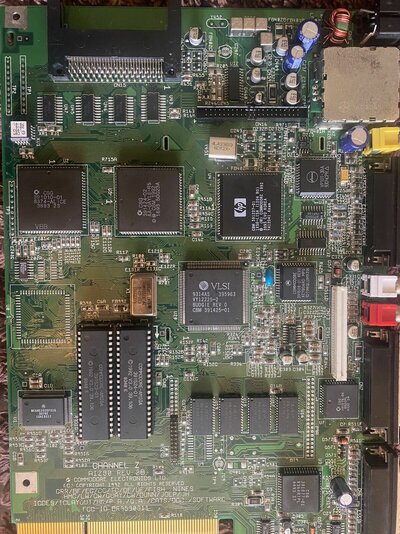

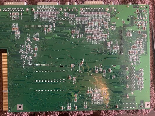

Can anyone maybe see anything wrong on this board

That board doesn't look as if it's been recapped IMHO.
I was thinking the same. But I was under the impression they looked like Panasonic Caps? I know the light blue Shoei Caps can be spotted a mile off. But it all depends if Commodore Changed to another brand before they went under. Especially being a 2B revision.
Well not to be that guy. Why on earth is the board on a carpet that can cause electrostatic discharge?
Anyways. One thing I have noticed. Not sure if you are using an Accelerator board? But the 2B board hasn’t had its timing fixes done.
See here for a list:
carpet was under just while i was inspecting the board so it dos not slide around table,I was thinking of using PI storm 68 with this amiga
there is no leakage under the caps, and cap 21 has rebuilt trace, that is why i think the board was recapped.
Commodore used whatever components were available/cheapest at the time back in the day.
Just look at the power supply with different coloured wiring in some, which makes it all the more important to check what one goes where. I have also seen different coloured capacitors on same revision boards over the years which has given me pause for thought and going on to triple-check.

Is this something you can reproduce repeatedly?
You might have board bend. Try flexing the board. Or laying it flat some how. Some of the connections on the board maybe dodgy.
Once on a flat hard flat surface such as a table, press gently down on each of the mainboard's four corners to see if there is any movement or rocking - you should see the one or possibly two of the other corners lift up if there is.
