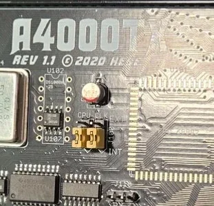

yeah you may have to change it from Int to Ext let me check
From The Cyberstorm MK3/PPC manual
Before the carrier board is inserted, the two clock jumpers marked on the main board under the CPU-board with "INT" or "I" and "EXT" or "E", (see Figure 3), have to be put in their proper position. For the operation of the CYBERSTORM PPC they have to be placed in position "EXT" or "E". Depending on whether you are using an AMIGA 4000/030 or AMIGA 4000/040, these jumpers by default are set to on position "EXT" or position "INT". Please take note that the operation of the CYBERSTORM PPC is not possible if the jumpers are set to position "INT", and the computer will not boot in such a wrong position.

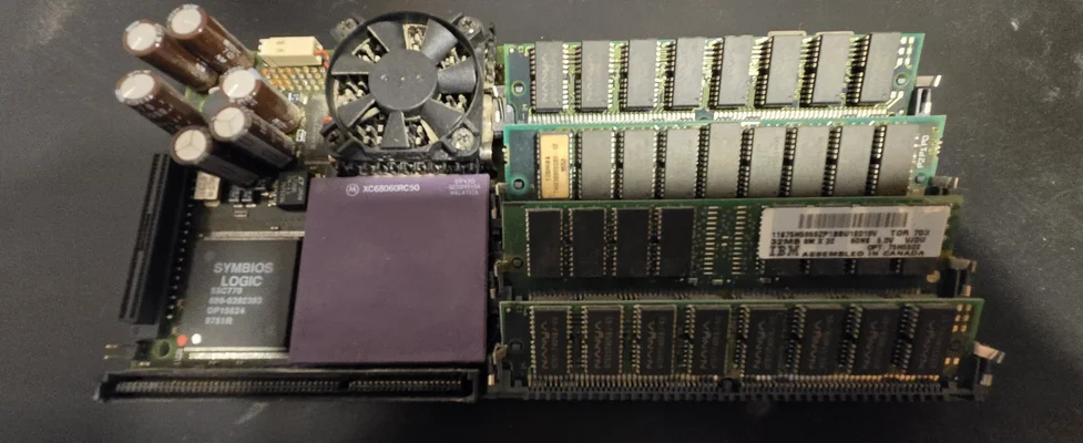

The only issue is do you know if the Cyberstorm is functional? because a black screen can be CPU related I believe
The two jumpers are the two that need to be changed to EXT for the cyberstorm can you take pictures of the cyberstorm too please.
Well it was switched off working 30 years ago!....thats all i can say...ive not got anything else to test it in!
OK cool so did you change both them jumpers to Ext before installing this card?
