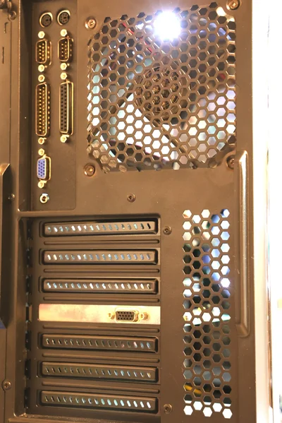

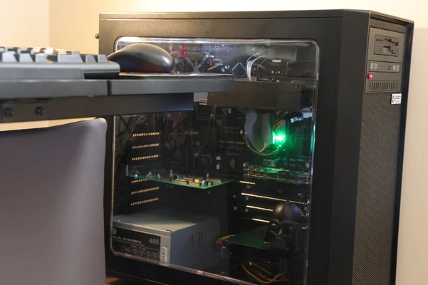

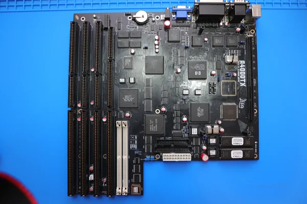

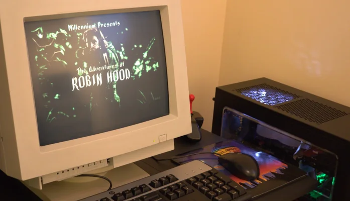

I'm finished with my Amiga A4000TX. Here are some photos to illustrate my work.
Two "imperfections" remain:
1- The TF4060 card doesn't like PIO2 mode, so I downgraded it to PIO0.
2- With a 2.5" hard drive on the TF4060 controller, Sysinfo crashes during the HD speed test!

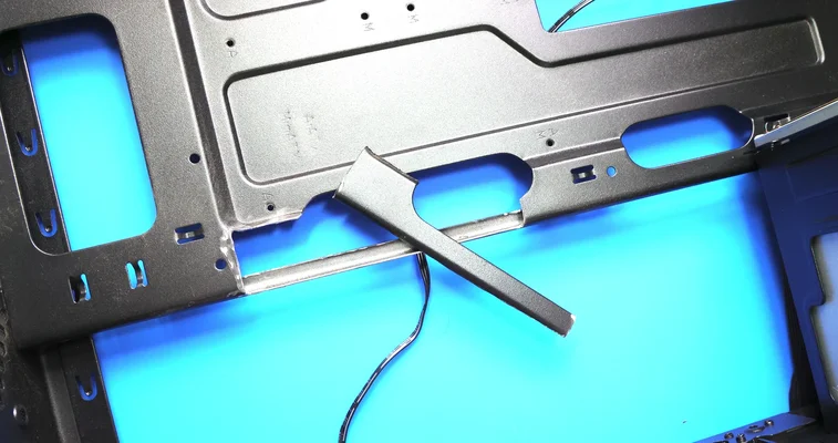

The Fractal case fits well! But you have to trim the base as shown in photo #1.
The CD-ROM is a notebook model mounted on a DElock cradle, which also allows the 2.5" HD drive to be installed.
I'm delighted with the result.
