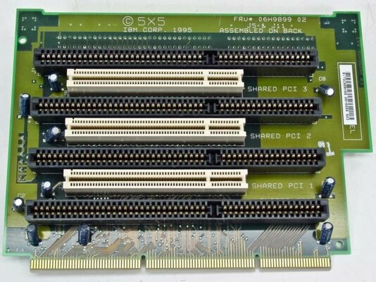

2, Can the Zorro connectors be be broken out and put on a daughter board? Making the board instead, So the mb will be a regular ATX board. And connected with a ribbon cable to the daughter board. That will also allow you to mount the cards in those vertical slots that cases now a days really like to have.
I saw this and was something I was thinking about too. But, was thinking a more inline slot. I've seen it on HP oem mobos for pci slots. It'd probably lead to other 3rd party expansions too.

I'm no electronics engineer but wouldn't hese just have to have a Zorro slot inline with a PCI slot and then you would fit one of these,
http://eu-shop.elbox.com/en_GB/p/Mediator-PCI-4000-MK-III-MM-CD/646
This would give access to say maybe having PCI slots fitted in place of the ISA Slots?
This could be another version of the board maybe because there will be some users out there who would also like to utilise the ISA slots fitted to his current design
This is really impressive I will wan't one when PCI is added. I can then just use the Elbox logic board.
Also if you add Meutoxo's 112MB Mod, you could drop two of the SIMM sockets freeing up a bit more space for another Zorro Slot.
I don't know if this is possible either, I know one PCI slot will have to be in line with a dedicated Zorro slot like they are on the Mediators but could this also be a possibility?
But again I understand that this would required a lot of redesigning so maybe on your next creation hese :lol:
