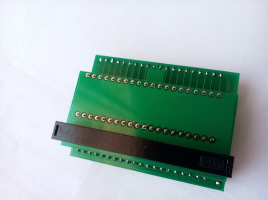

Some informations in pictures! ;)
The problem is that I have made PCB to be plugged directly into the socket of the Amiga motherboard.
I don't want to waste my time in ribbon soldering. So, I have decided to use two little PCB adapters instead of one.
One will be plugged onto the motherboard, the other one will be soldered under the Kickstart Switcher.
The 40 pins connector will be a standard IDE male connector or connector like the one which can be seen into the pictures.
Actually, it's like that, for the next batch, I'll see to modify the design to avoid the second little PCB.

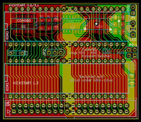

As you know, initially, the Kickstart adapter has beeen designed to be plugged directly onto the ROM socket of the Amiga. The idea I have shown in the previous post is a solution to use a 40 wires ribbon to connect the Switcher to the Amiga. But, it's not a good solution for me because the Switcher with 2 x 40pin strips ans the little PCB adapter soldered under is bulky. In this case, we have one PCB for the Switcher and two other PCBs for the ribbon...
So, I have decided to make a new design to limit the cost and the volum of the Switcher. This one uses only two PCBs. The little ribbon PCB adapter and the Switcher PCB. I have replaced the 40pins socket by a 40 pin connector (HE10). I'll send the files to the factory this evening. I'm sorry for the delay, but I really prefer to make like that. The adapter will be finer... and it's better for our Amiga where there is not so much place available.
Components are already ordered. The PCB should be ready in three weeks (maximum).
The "standalone" Kickstart switcher which is plugged directly onto the ROM socket of the Amiga is always available. It's a perfect solution for A2000 with accelerator boards plugged into the processor expansion connector, or for A500 with external accelerator boards (GVP, ACA500,etc). So, if you are interested with this version, you can declare your interest, they are always available!
I hope you understand my approach.
Waiting is not a problem, but please post pictures of the new design when you get the boards, because I can not imagine what it will look like :)
Will look like that: :)
The Kickstart Switcher will be directly connected to the ribbon via the U4 40 pins connector.
The Reset signal will be pick up by the little PCB ribbon (new version) and bring to the switcher
via one unused pin of the 40 pins connector.
