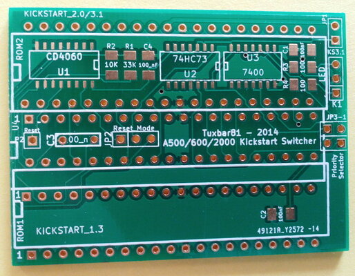

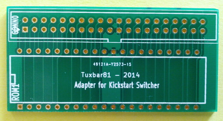

I 've just received the PCBs for the A500/A600/A2000 Kickstart Switcher!
Components ordered. I hope to receive them before the end of the week.
Kickstart Switcher PCB:
Ribbon PCB:
Voilà!:)

One question...
Are all combinations possible ? Say, 2.04 left and 3.1 right ? Or only 1.3 left and 3.1(2.04) right ?
I have put onto the PCB "Kickstart 1.3" for ROM1 and "Kickstart 2.0/3.1" for ROM2.
But, you can use the Kickstart Switcher like this:
- ROM1: KS1.3 or KS2.0X & ROM2: KS1.3 or KS2.0X or KS3.1
The only restriction is for KS3.1 which must be onto ROM2 with jumper JP1 closed.
But, it's not a problem, because the Kickstart switcher allows to choose onto which ROM (1 or 2) you want to boot by default by using JP3-1 (Priority Selector).
The jumper JP2 is used to select the reset time to swap between kickstarts (3 or 10 seconds).

The Kickstart switcher can be plugged into an A2000 PAL or NTSC. No différence.
You want to plug it directly into the ROM socket of the motherboard, or with the ribbon PCB adapter?
