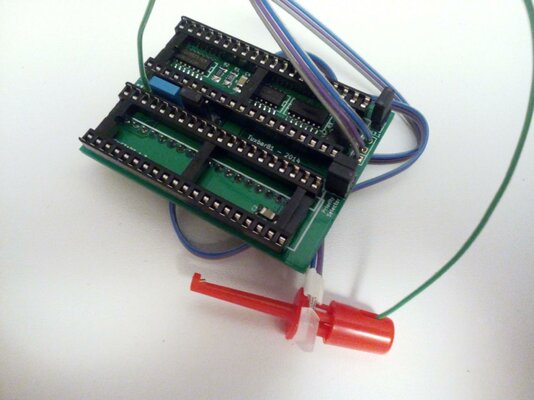

Here is a stand alone version finished. I waited for the clips electronic test which are arrived today.
The clip will be used to pick up the RESET signal. Like that installation 100% solder free!:)

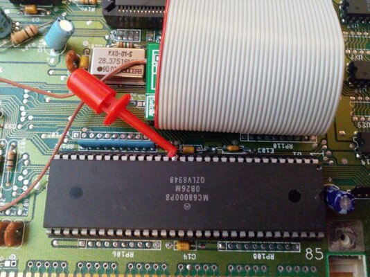

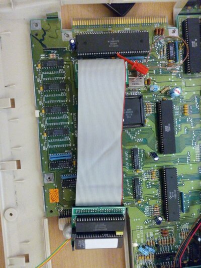

Here is a Ribbon Kickstart Switcher onto a A500! The ribbon is a little bit too long in my mind.
Reset signal is picked up from pin 18 of 68000 with mini clip... no need to solder.
The A500 is under KS1.3 -> Drive LED is red.
The A500 is under KS3.1 -> Drive LED is green.
When the drive is running, it's LED is yellow.
To obtain the red and green color onto the drive LED, it's simple... I have plated the LED of the switcher onto the LED of the floppy drive. No modification of the case needed!:)
