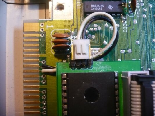

can somebody who has also installed this in an A1000 help me? I have connected INT2, OVR and GND but WB 1.3 still shows me 512kb RAM. I took the signals from the expansion port (Pin 13, 17 and 19). This is beginning to frustrate as I'd expected to get this thing working out of the box. There is no guide or anything else for help.
In picture, the board is v106 (ide cable on other side than in v4xx),
the card edge is of interest, black wire is /ovr, white /int2
Like in A500, in A1000 card edge, /ovr is position 17 and /int2 is position 19 contact, on the top side. (even numbered contact positions are on the bottom.)
They are close to 68000's pin 32/33-end. (in a500 cpu pin 1/64 end is to front, in a1000 to back end of Amiga case.)

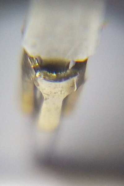

I sent the replacement board to Cego, and tested it and each socket holds pins individually using this method:IMG_20180818_213726.jpg
Possible problem of loose socket for 68000 pins, if height permits, could be solved by a dip-64 socket or sil-strips.

Problem when removing 68000 from socket pins that I've been using lately:
For a few pins, part of socket comes of with cpu pin. I could put and push them back to socket cups, but are tiny and get lost easy.

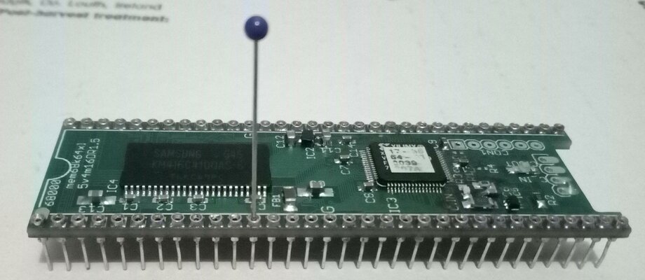

I think there maybe some issues with v6x boards, with a tmp68hc000 on external side slot cpu adapter board + ram on mainboard test socket ram worked,
but mc68hc000 on ram , on mainboard, keeps resetting and doesnt boot.
I will be testing and trying to find the cause.
EDIT: possible fix posted below. (using older verilog source, abel code bug not found.)
Using older verilog source to make working(i believe, after quick testing) cpld code for v6x boards. compiled with xilinx ise 6. The Abel version still needs debugging.
edit:ucf file missing from zip, can be found on the www-page http://www.mkl211015.altervista.org/ram68k/
The bug, I think is maybe refresh cycles not separated so that ram chip interpretes the signals as a read access cycle, interfering with cpu? And in v59 ram, data buffer chips would have isolated ram from cpu data bus. Perhaps for some reason, timings of some cpus mostly prevent bus conflict most of the time.
