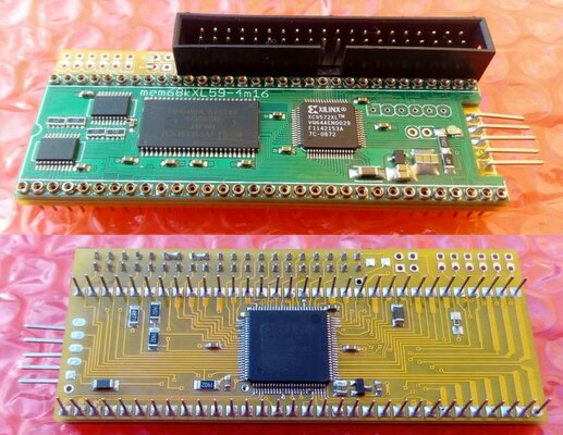

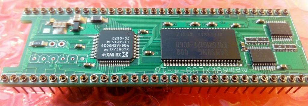

Hi. I will have, for the time of next week or two, only one ide+ram board for sale.
A few V402 or more V4xx boards and idecf adaptees could be available later.
All four boards shipped to highpuff.
The other one has plastic strip insulator pushed between boards and tape wrapped over boards (provides some protection to the circuits.)
V61 ram has both config in and out available at pcb pads.

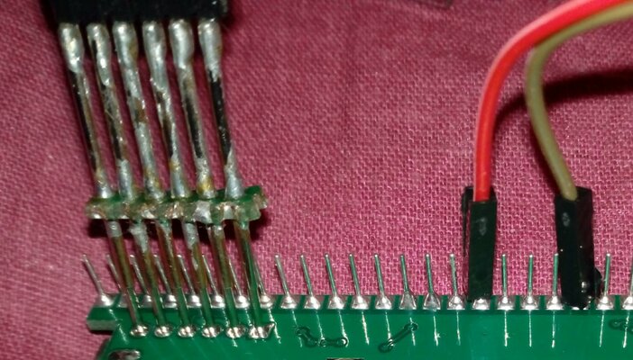

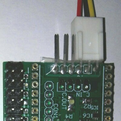

Boards have 6 pins at the end. Connector in picture has /int2 red, /ovr black, ground yellow.
Ram v61 and v62 have pull down resistor for config in to enable it when not connected elsewhere.
V64 has pull up, and solder blob jumper to gnd.

A Ks-rom with a600 ide driver is needed (such as KS3.1 V40.063)
and two wires connected from ide board to amiga mainboard.
If there are no other autoconfig devices, ram board doesn't need connecting wires.

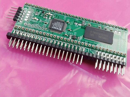

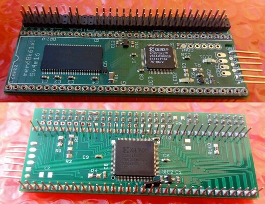

V59 and V64 ram
