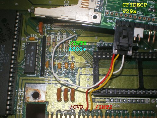

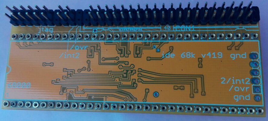

Hi. If there are 6 pins at the end, the edge is gnd, if there are 5 pins, third wire can be clipped. int2 and ovr to be connected
Info page www.mkl211015.altervista.org/ide/ide68k.html
scroll down to version table for pictures of int2 and ovr connections.
Pin-out on silk screen
