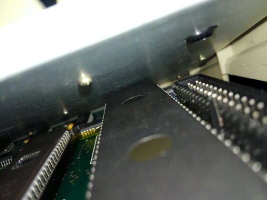

Stacking of boards
-Under A500 keyboard is limited space
-so separate boards that each have their own socket pins, e.g. ram and ide and cpu plugged in to a stack, is too high to fit in a500.
-space limited in cdtv
-stack of two boards should fit in a2000. a1000?
-A soldered combination of ram(v59) and ide(v4xx), to same (separate type, not the very long strips on plastic black body) socket pins (with kapton insulation tape in between) will fit.
V59 can be plugged to top side of v4xx style ide boards, but it maybe tight with the polarising tab of idc cable connector or maybe not fit with boxed ide header (ide v402/v418). v401/419/420 have 1.27mm of extra clerance to ide connector.

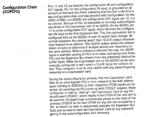

A500 has config out contact grounded, this can be cut and replaced. Some of the side slot expansions can feed its config out back to a500 side slot contact?

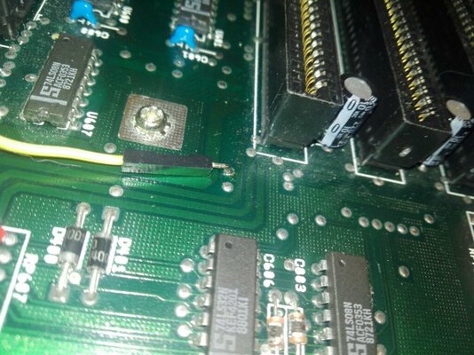

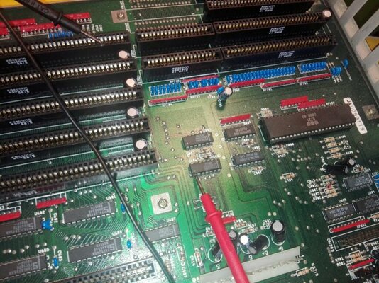

Amiga 2000 has config in, out on zorro slots. Could make contacts with pcb material like vero board maybe? Config-in to ram board can be taken from last zorro slot (or pin 8 of u606 74ls32 chip.) leaving the slot otherwise unused.
In V4.4 the signal should be found also on a pcb via:
IMG_20180811_161246-1024x768.jpgIMG_20180811_160956-1024x768.jpgIMG_20180811_161506-1024x768.jpg
Amiga A2000 version 86-pin slot has config in but not config out? B2000 version should have both. Page 94 in A500 A2000 Technical reference manual

Stacking of boards
Under A500 keyboard is limited space, plugging ram and ide and cpu is too high to fit. (1000/2000/CDTV?)
A soldered combination of ram(v59) and ide(v4xx), to same socket pins (with kapton insulation tape in between) will fit. Install to CDTV link..
tact?
i hope I understand his correctly, but a ram plus IDE board with CPU plugged in won’t fit under the A500 keyboard?
Stacking of boards
tact?
Correct.
You would either need to remove the 68000 socket and directly solder these adaptors into it or obtain an 68000 socket relocator to move these boards away from the keyboard.
Stacking of boards
tact?
I believe that soldered to same (10mm pin length) pins combination of boards will fit, I will recheck this. But separate boards with own pins each won't fit.
