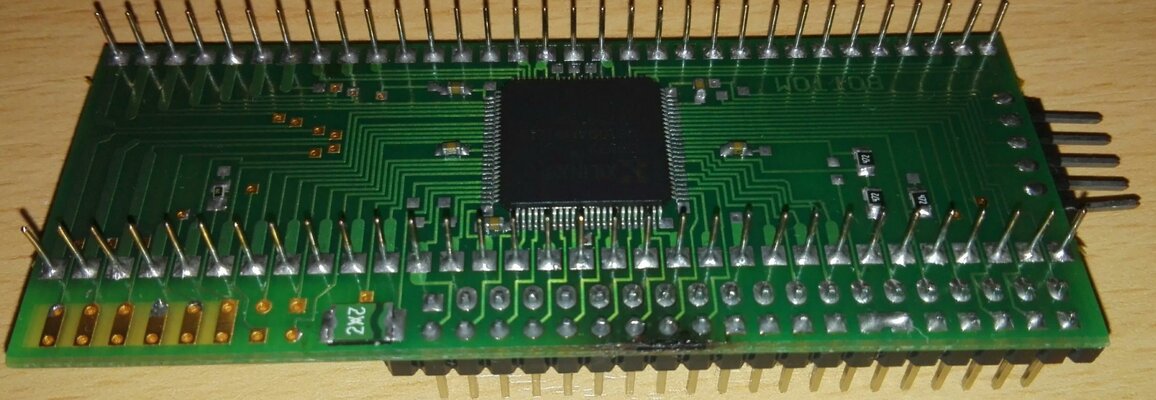

IDE68K at the bottom of the 68K socket stack. I believe it's the 402 - the one without the CF module slot that would impact the A1000 floppy metal - the IDE header pins are alongside the upper # pins side of the 68K. Note: I ordered mine without the IDE header and without the Int2/OVR or LED pins installed. I wasn't sure what I was doing as far as the IDE physical intrusion, or the wiring, and I wanted options. More further down.

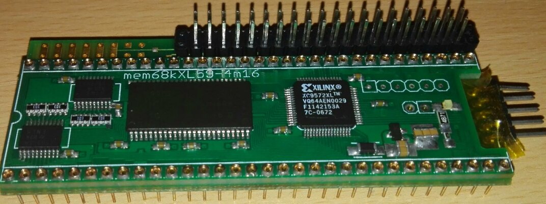

mkl 8MB under-68K module from this sale thread. Autoconfig works fine for this application.

IDE68K - The IDE header - I ended using an non-shrouded 40-pin straight header (notch faces the CPU, pin 1 rearward, for reference). If I had decided to use an IDE cable, I was likely to use a 90-degree header to let the cable then naturally drape up and across the top (the hard way was also possible - solder the cable in). I chose a 2GB industrial IDE DOM module that sits vertical on that header. The IDE port power is driving it, so no need to wire a power header. Thankfully the height of the Spirit board pins raises things very high and there is a very slight angle giving me room for the PCB overhangs further up.
The IDE68K INT2/OVR/LED header pins I took the 2nd option connections at the #34/35 pin end of the board. I used 90-degree single row headers on the PCB top that work here because of the Spirit Insider is high above. Also, the hop to the 86-pin connector for signals off the motherboard edge connector is short right there. Don't go hunting for chips to solder to elsewhere (and possibly damage) - just pull out the Amiga RKM and find the correct pins and solder a header pin into each via (the signals are underside edge pins, but a large enough via comes to the top with solder that can be cleared with a sucker will fit a standard header pin). For counting, pin 1/2 is toward the mouse/joystick ports. OVA is 17, INT2 is 19, even on top, odd underside. Verify signals on the edge to the actual chips with mkl's notes and a meter (continuity). With headers in place, you can use colored jumper lines (for arduino projects) to connect to the pins - easy disconnect if you need to pull it out. I used 90-degree headers along the 86-pin, but vertical header with a slight bend inward will work.

The mkl 8MB unit has a low 90-degree 3-pin header for RAM enable/disable. I had to replace it with a standard height 90-degree header to clear the IDE DOM module from the side. A vertical 3-pin header would have also worked - I just had spare cut-strip from the others I cut for the project.
