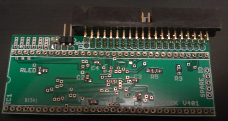

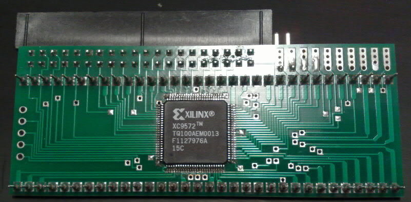

Assembled, but untested v401. The cpld code is not yet fitted.
These are absolutely perfect. When do you expect to finish them/test them ?
This adapter has 40pin IDE connector. So it will need a power plug ?
In may. I've connected to the board with jtag, I could erase the cpld, but i have no code to program it. Needs adaptation from previous abel source code, I'm going to use one master abel source file with optional bits for each ide68k version.
+5V supply on the 40-pin connector might eliminate need to externally connect power to a IDE-CF adapter connected to it. Or IDE-SD, IDE-SATA, which might work with ide68k(?).
So we will have to power the adapter (i mean cf adapter connected to the IDE) from the floppy connector of the mainboard.
Right ?
Right ?
No, it's the other way. If your cf-adapter supports taking power from that key pin position, it will get it through the 40-pin connector of v401. Are you thinking of an cf adapter with male (to cable) or female (to board) ide connector? The latter type might be more likely to be able to take power directly from 40-pin connector .

Previous ide68k had 39-pin connectors where polarisation key pin was removed to allow 80-wire or other key pin polarised ide cables.
---------- Post added at 12:50 ---------- Previous post was at 12:48 ----------
To v401 pcb you can solder a 40-pin header as well as a 39-pin header.
