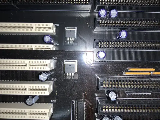

Okay as per the subject. Looking to add an extra molex connector like you find on the Firebird Prometheus Daughterboard.
Reason for this, is that in one of my A4000 Desktop setups, I have a Mediator MKIV Daughterboard. But have noticed that with a Voodoo 3, x-surf100, gottagofast3r 256MB Z3 and a Spider-II USB card. I get issues with the Spider-II disconnecting itself and going offline. Also when trying to use tested and working Voodoo 4 cards, they don’t get detected. Yet works fine with Prometheus with the added molex power.
Anyone know a way to add extra power to the mediator Daughterboard directly? As I suspect this is my issue.
My current setups all use ATX Corsair 450 or 600 SFX PSU’s with power converter adapters for the A4000.
Note: I already have a couple of Prometheus Cards (V1.0 and 1.1). This setup with the mediator has a Cyberstorm and AmigaOS 4.1FE setup. Therefore why the ask.
