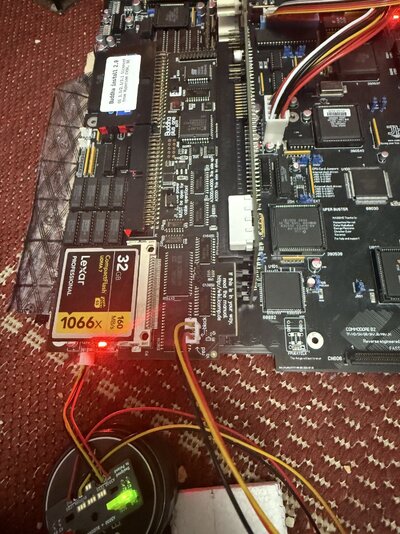

Mmmm, doesn’t seem to be doing anything ☹️
Okay just noticed something in the picture of the Buddha, Jumper J1 is off? Check the instructions in the manual, but will mean the DOM you have connected won’t work without it.

The DOM is in ide 2 and the jumper is connected. There’s nothing in ide 1

If you are still having issues with the Buddha, maybe worth a try over on the Icomp forums. I only own a couple of the 20th Anniversary editions. The instructions for those clearly state about a couple of jumpers needed to be covering the correct pins for power etc.. to allow the DOM to work correctly. Ten remove said jumpers when attaching CD ROM drives etc so not to burn them out with extra DOM power etc..
