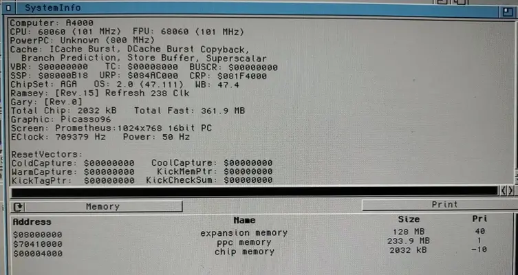

Has anybody tested Firebird with PPC board with 256MB+ of RAM. I have Ragnarok with 512MB and there is visible only 233MB in system. The same was with Apocalypse G4.

I believe you can only allocate up to 384MB of PPC RAM as fast.
You’re lucky, as I can only muster around 128MB at the moment on one of my builds.
Yes, I know that on Mediator there is limit up to 384MB of PPC memory (that's in SonnetLib documentation), but I haven't found anything about limits of Firebird.
If you're right I should see 384MB of ppc memory not 233MB. I don't know is it configuration problem or limit of Firebird or SonnetLib.

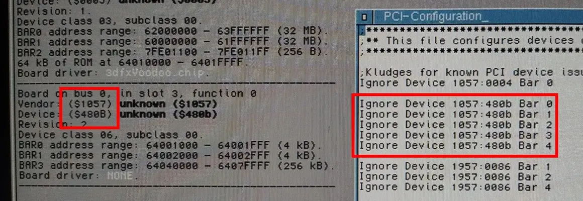

So…..
Still no joy with Thors 40.x OpenPCI.libs.
Tried going through the Thor Documentation about setting GrantdirectramAccess=YES etc.
Lspci shows cards and dmamemtest shows DMA working well…. But startppc says no PCI PPC card found…
If anyone has membership over on EAB to ask why this is so? Then please feel free…..

I tried to run it with Thor's PCI library too, but with the same result.
I found in PCI-Configuration that my board is ignored on pci initialization. I tried to comment out this lines but it didn't help. Maybe there are some known issues...
I asked on EAB and waiting for answer.

One more thing, I saw 386MB two times when I was trying to configure it, but I don't know why. It probably happend when PCI bridge was first initialized with Thor's library and then system was rebooted with old OpenPCI 2.1 library.
Unfortunately after turn off Amiga it is once again only 233MB visible. I didn't find a rule when it happends, but it happened two times.
