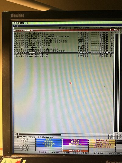

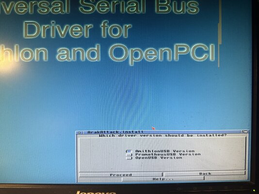

I moved over to install the ELBOX Spider II PCI USB card (the only PCI USB card I have presently)
I followed the USB Setup instructions
1. Install Poseidon V4.5 then Restart => Installed the Poseidom4.lha which is available from the EBOX support website (Spider II download area)
2. Install Arackattack when asked to choose ā€œPoseidonUSBā€. This will take some time and appear to have locked up. Then click proceed. => Downloaded the version from Aminet (link you provided)

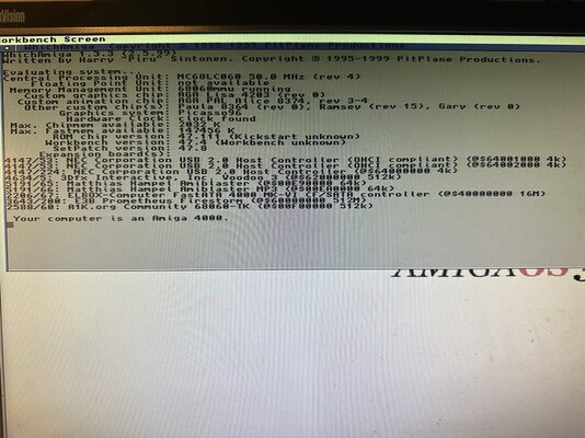

During the Arackttack installation, I couldn't see the option "PoseidonUSB" (instead 3 options were shown, one for "AmithlonUSB", another for "PrometheusUSB" and the last "openUSB" (OpenPciUSB) image attached.

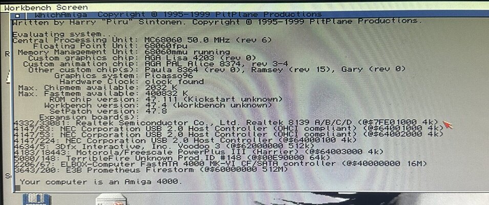

3. Open prefs:Trident and make sure that there are 3 ports online and active. => No ports show as active

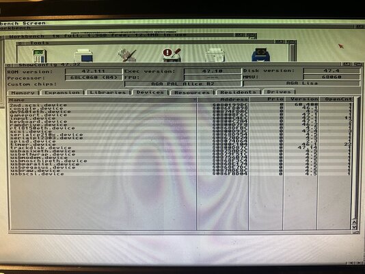

I have one ELBOX Spider II installed (see the witchamiga image attached). I have spider.device file at Devs:HardwareUSB but is not seen as loaded (see image, showconfig devices area) in the system. Does the ELBOX spider device driver only works with the ELBOX PCI.Library loaded??
Although the spider.device file in the Devs folder have not been loaded by the OS.
Hi,
It’s been a while. Go for ā€œPrometheusUSBā€, if that doen’t work try openUSB. The Spider-II USB driver is only meant for the Elbox Mediator PCI board. So that will be no use to you using a Prometheus.

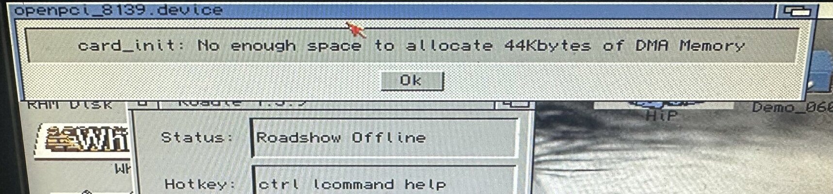

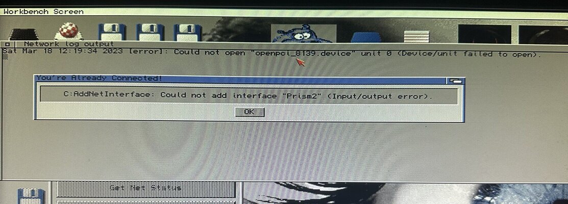

My new RTL8139 arrived
Confirmed that the other one was damaged
The new one is properly detected

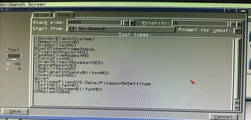

The issue is that when I try to connect it on roadshow I get an error that I cannot allocate 44kByted of DMA memory
My Voodoo 3 2000 have the DMAsize=2048
did I missed anything ?

Yep.
As per my guide:
On power up of the Amiga workbench if you get ā€œCard_init: No memory for DMAā€ then check the Prometheus monitor file has the DMAsize=2048k (the k on the end is not a typo, has to be included in the line).
The entry you have just has DMAsize=2048
It has to be DMAsize=2048k

Yes the k. DMASIZE=2048k
Thank you
DMA memory error solved

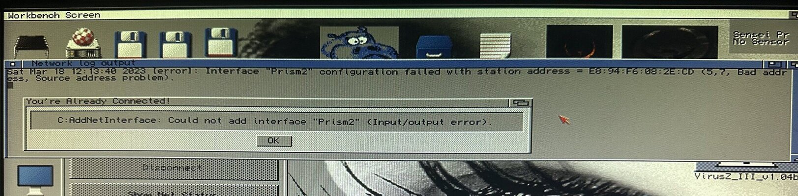

But now I get another one
I may need to connect a network cable to my router
The one I have is too short

The RTL cards as far as I understand it doesn’t use prism2. This is for PCMCIA network cards.
You did get the drivers as specified in the guide?
OpenPCI Libraries and Drivers (Network Card - openpci-rtl8139) Link: http://bvernoux.free.fr/DevPCI.php#drivers
Now I got the cannot allocate 44kByted of DMA memory error with rtl8139, but my setup differs a bit.
A4k + Firebird (Hese) + Cybervision 64/3D in Zorro slot. I have DMAsize=2048k in tooltypes and monitor file renamed to Prometheus. RTG itself works.
So does the RTG card need to be PCI card for DMA to work?
As far as I understand it. Yes the Prometheus channels the DMA from a PCI RTG card such as a Voodoo or Radeon card, very much the same as the Mediator boards do. This is if you are using other PCI cards. For Zorro-III it’s just the same as the normal Daughterboards.

Could you help me solve this problem:I installed a 4 USB port card with NEC chip on my firebird a4000.I installed Poseidon 4.5 restartI installed Arakattack but when it asks me to choose I don't see PoseidonUSB but Prometheus USB.After the installation when I go to Prefs:trident the device appears in red (not active) and in the notes the following appears:
"Opening Devs:USBHardware/ PrometheusUSB.device unit 0 failed device /unit failed to open (-1))
Could you give me some suggestions to solve it
