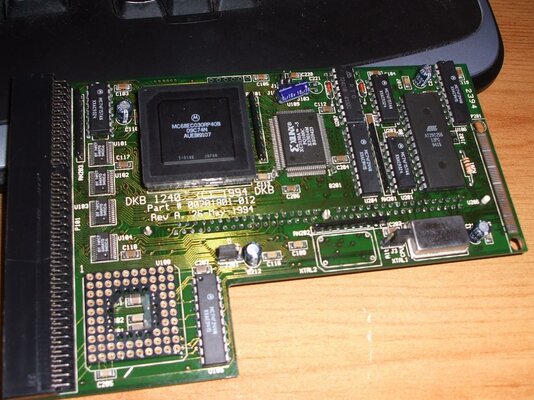

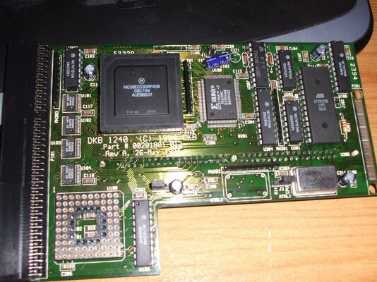

I could try, if it can stay stable for long enough (it sometimes does but rarley). I have had a look here: http://amiga.resource.cx/exp/dkb1240try to reflash the rom. It helped a friend of mine with the same board!
Sometimes they get corrupted.
I can give you a contents if you want ,your serial number will not be the same though.
Cheers.
Apparently the Ferret disk has the ROM update, is that true? If not, how would I update the ROM?
Take the RAM off the card. The original firmware on those cards isn't compatible with Kickstart 3.1 if there's RAM on there. So, either swap the Kickstart ROMs (faffy) or just take the SIMM off.
Then you boot the Amiga off the Ferret disk (It's available from Amiga Resource) and run the flash updater.
If it's not been flashed, it's possible your problems are just down to this incompatibility.
