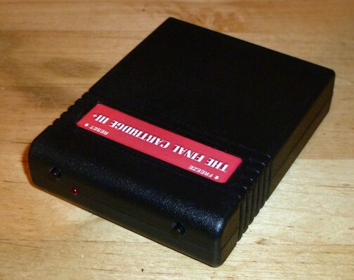

:) Kids distracted with new toys = Time to put my new Cartridge in a case....
Bryce.
Wow! I really like it. I think the label really pops on the black shell. :D
