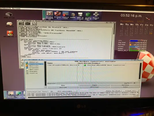

Okay Update time. I now seem to have fixed my issue. This is what I did:
1)… Re-updated with AmigaOS 3.2.3 to fix any version Anomalies (This also applied 3.2.3 icon.libraries). This now fixed my icon information issue. Prior I was using an old version of iconlibs46.4 off Aminet
2)… Re-edited s startup-sequence to put back in C SwitchControl (using a RATTE monitor switcher with Aga MK3 and Voodoo3 RTg card). Fixed my workbench back into place in RTG mode. Also put back stackattack syntax ready for MUI 3.9 installation.
3)..Installed MUI 3.9 from the Ibrowse website download page. For both Ibrowse Netbrowser and Poseidon V4.5 for RapidRoad x-surf 100 USB.
Just to note: make sure in your s user-startup MUI installer has placed assigns of MUI. See photo attached in what I mean.

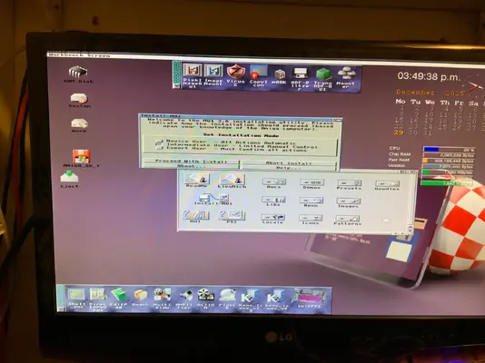

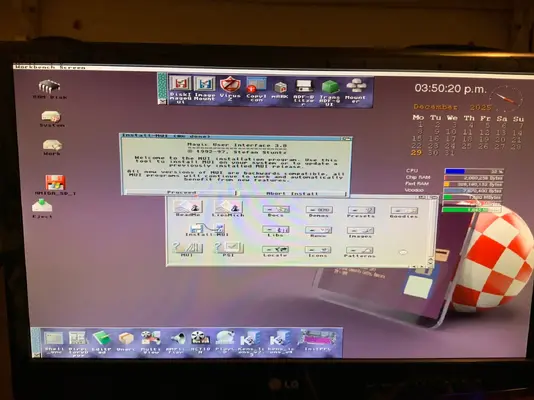

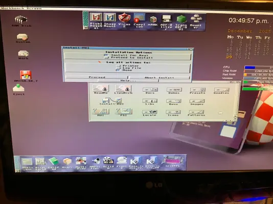

Hi guys, when installing MUI3.8 it wants to install into the storage folder? What do i do with it then or is that the wrong folder?
That doesn’t sound right…
Here are some pics of a MUI3.8 installation using “Intermediate”.
The aim is to install MUI into your AmigaOS partition. Mine is called “System”. Not sure what you have called yours..
Hope this helps?
Note pic 4 & 5. The installation wanted to install in Amiga_SD_T
I clicked on “Show Drives” and changed this to “System” (My AmigaOS Partition). You change this to your AmigaOS partition. Then click Proceed.
