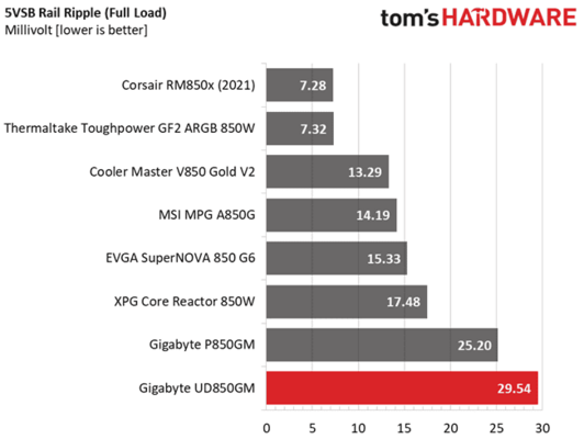

@atomontage ....maybe this ripple problem on ATX is not that bad? Tom's Hardware notes that the spec limit is 50mV on 5V, which would meet Commodore's needs.
The ripple limits, according to the ATX specification, are 120mV for the +12V and -12V rails, and 50mV for the remaining rails (5V, 3.3V, and 5VSB). Nonetheless, in modern PSUs, we expect to find a much lower ripple. It should be just a small fraction in high-end platforms with quality components and the proper amount of filtering capacitors. Below, you will find a schematic that analyzes a ripple waveform.
Modern ATX supplies don't usually have a ripple problem (that was mostly referring to the MeanWell supplies) just a regulation problem (with the Amiga) as their main rail is typically 12V and not 5V.
@atomontage, that's good to hear. I'm a bit relieved, was worried there about my Amiga.
By the way, 50mV ripple Commodore specification is only for 5V, correct? And 12V ripple at 120mV is OK on Amiga? Is there a spec/requirement for 12V as well? Again, really appreciate your knowledge and detailed feedback.

That's right. The spec is here (taken from Jen's slides, I'll also add it to my original comment as a reference), so you can see on page 3 they specify ripple for all voltages at full load (that's another point that folks who just measure ripple with an oscilloscope under minimal load are missing).
So for 5V it is 50mV and for 12V it is 120mV, which is ATX spec. This all makes me sleep better knowing all those ATX users are not harming their Amiga. :-) Thank you for this spec sheet link as well. This is a very informative thread for newbies thanks to you @atomontage.
