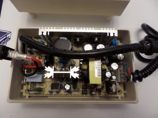

@sheepz, these 10cmx10cm mean well cubes will fit in the old A500 PSUs, but not in the 600/1200 PSUs, right? Which case are you putting them in, and has anyone found a good replacements for the guts of the smaller Commodore PSU 600/1200 cases?
Hi @YouKnowWho
I have sold my others with my A500s but my A1200 uses the PCB from below. You do have to cut some of the internal plactic away but it fits will in the A300/600 Power Supply - P-No: 391029-02, needed a bit more work in the A500 312503-02. Looking back and now I am better at soldering I would not bother with the PCB. I have re-capped a few old PSUs (did that to my A4000 before changing to ATX SFX PSU) and the give good votages. I wonder if people have issues with recapped original PSUs other than the age of other components?
My uncle that got me into amigas still uses an old Goliath PSU in his Blizzard PPC 603e upgraded A1200 and that's just an old PC PSU in a fancy case and its be one the go for 30 years!
PCB
Goliath PSU
Regards

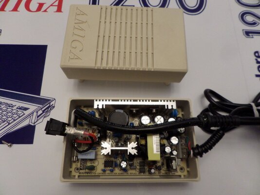

I did some testing of the Mean Well PT-65B; stock, it shows the 5 V rails (it sports two) as 5.1 V without load, 4.99 under load with a TF1260. The 12 V rail was 12.7 V but with a load, it was 12.15 V. I added in the Buck DC-DC adapter set for 12 V, without load was 11.8 V and with the load came to 11.35 Volts.
Assuming that the one I used was a representative sample (I wouldn't use this data for a senior's thesis) and that an error of less than 10% is acceptable, either a stock PT-65B or a modified one should be acceptable. I went ahead and used it as stock, putting it into a 3D case found online for this model.
As far as original cases meant for the A300/600, 500, and 1200, the PSU fits those cases either as is, or when mounted upside down, with the occasional septum needing removal. Do to the minimal heat generated by the Mean Well, the upside down location appears to be fine. Under a prolonged load, it is only warm to touch.

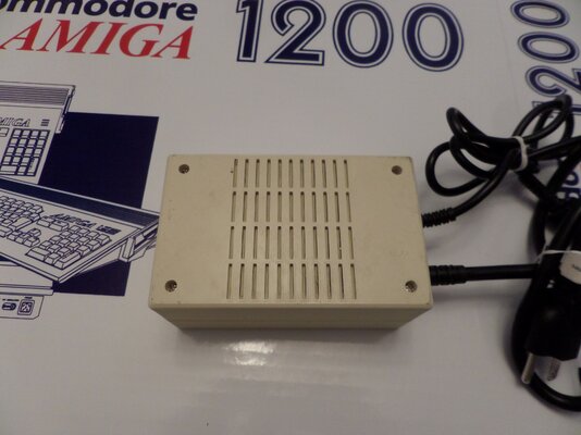

As I have about 13 PSUs, with 8 stored in reproduction boxes, including a storage container of 5 more, I find the request to disassemble my current PSUs to take photos not worth the information gained. I'll disassemble the one described and take a couple of photos in a bit, adding them after I post this text.

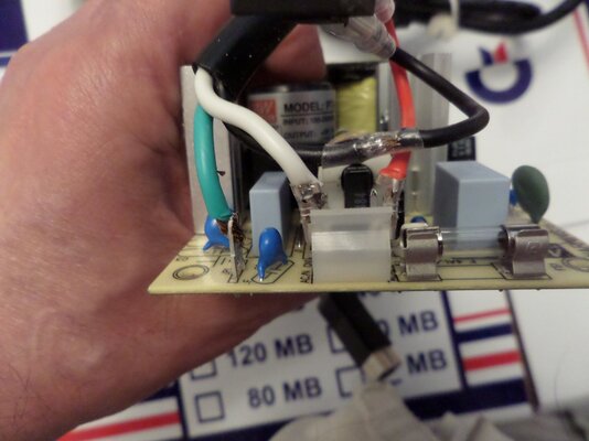

The specifics of the tested build described has wires tinned, then soldered to female connectors (type as recommended by the MW documents) for all connections except the line ground, that is directly soldered. The pin connectors all have the exposed female connector covered with heat-shrink tubing should one be pulled so aggressively that even the strain relief booting fails to work, the free wire can't short against what it touches. This way a freed wire remains isolated from contacting something causing a short.

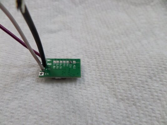

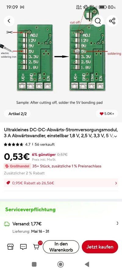

I have this DC-DC thing but I don't understand how to use it.
See if it's ok - after your coffee. Coffee is a RITUAL
01. I cut the line on the back as showed in pictures.
02. I solder my Amiga +12 cable on the +12 on the back.
03. I connect VO+ from the converter to the +12 on my MeanWell?
3.45 PM here in Italy so I'll virtually join you for a coffee break.
Still sipping coffee, but at 9:44 AM in Indiana (US).
You only cut that one line to disable the potentiometer, which is tiny, a piece of crap, and causes more voltage issues than not. There are 4 connections, Input voltage, V-output, ground and EN for a positive voltage to enable something I've already forgotten as it wasn't applicable. Then solder a blob at the 12 V line and see if it gives you the 12 V measurements you desire. You can leave the potentiometer connected, and play with it to see why it's best left out of use.
In my setup, having it inline posed logistical issues, such as needing to heat shrink wrap it to prevent shorts, sticking it in a location that holds it in place, so it doesn't flop around and come loose, and such.
I'll get up now, take photos and return.

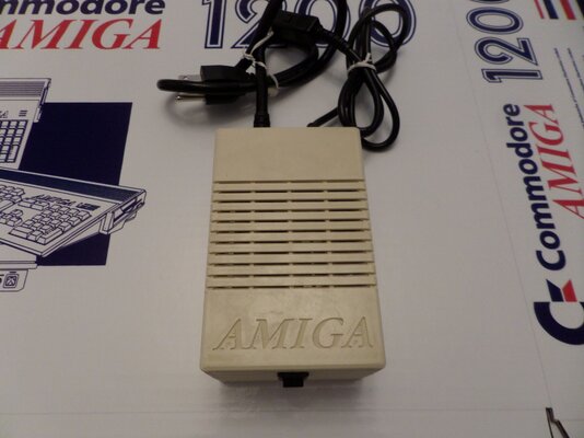

Photos:

Wow that's a clean work.
Where's the DC-DC converter?
Not included. It gave sub-par voltages, would have had to have been shrink-wrapped, and there was no convenient location to glue it.
