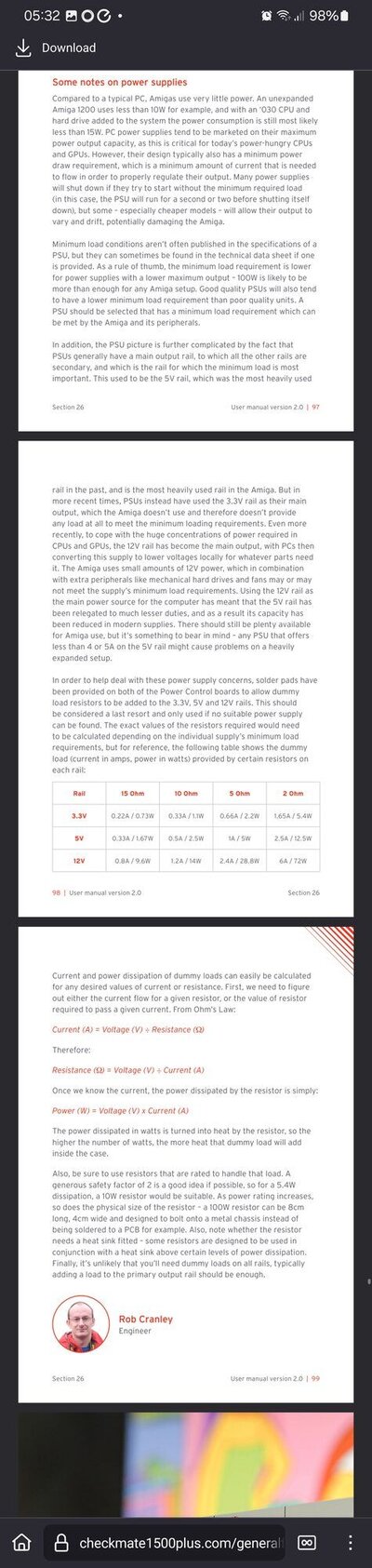

In the Checkmate 1500 Plus manual there's a separate chapter discussing how to add dummy loads of the PSU isn't behaving.
The chapter is called "Some notes on power supplies", and is found on page 97.
