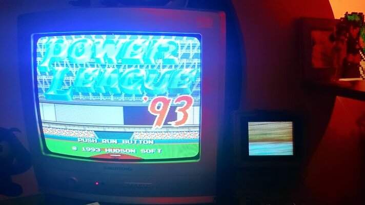

It does look amazing on my Sony Trinitron using my Core Grafx. Couldn't get it working on my PC Engine LT - doesn't seem to boot up properly with the cable in so might be a power issue. I've got another power socket on the right of the LT when using the CD attachment so might try it with 2 PSUs plugged I'm one day :)
It's possible it could be a power issue, the amp draws from the 5v line. What does it look like when you do try it?
Sorry for the delay. There was nothing on the main TV, the screen of the PC-Engine just had some wiggly lines on it and I think I am right in saying the Turbo Everdrive was blinking orange, but I'll confirm tomorrow when I set it up again :thumbsup:
Thanks to Nicolahu, I got my RGB cable yesterday. Works great, but I also use a LT for most of my Obeying needs, but power it with a LEGO 10V Adapter and have similar problems:
The screen on the LT goes all wonky, which happens when the voltage drops to somewhere under 7V.
@sir_beaker: Try it with a standard HuCard (Maybe the Everdrive draws too much voltage) or with the LT closed / Screen turned off.
Thanks for the tip. TBH I had not even remembered the LT, but it looks as if the PSU does not have enough power for the screen as well as the Amp, I'm not sure what the power requirements of the ED are I'm afraid.

A PSU with a higher amperage would probably help. if the RGB amp draws power and the Everdrive does too then you'll probably be better with a 2A PSU, something like this: http://www.maplin.co.uk/p/maplin-20...fixed-voltage-9v-worldwide-power-supply-l46bl
2.25A would probably be more than enough for that sort of setup. I'm picking one up myself as it'll come in handy when I get a CDROM2 unit and install the RGB amp internally.
I've been working on an audio amp to go inside and have found that power is indeed an issue. I'm going to dig out a beefier PSU and give it a go myself.
