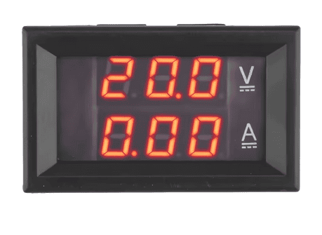

I have a Voltmeter + Amperometer as on the image.
When I give plain 5V on the Vampirized 600, it gives me 20A.
If I use only 1.3 or 3.1 KS it gives me 17A.
Are they right?

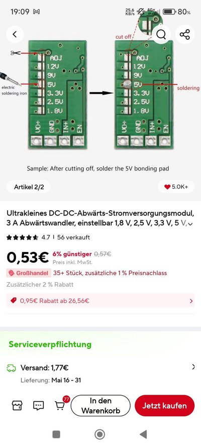

Now because of that You need to install some kind of additional DC-DC converter. I've took these:
And set them to 12V. That's it, now 12V rail looks perfect no matter what is happening on 5V rail.
This is incorrect, seems amp meter was connected wrongly and measurements are done incorrectly...
Best regards,
8 Bit Dreams
thats some weird and strange meter you have there that reads volts in place of amps,and besides all that strangeness ness,the meanwell only puts out 8 amps max on the 5 volt rail
not sure how you/the meter managed that,or even the meanwell supply
Thanks for all your replies. There's been a misunderstanding about my voltimeter.
The picture from the first post comes from Ali-Express, it's not on my PSU. This is where I bought my Volt-meter.
@8 Bit Dreams what is that little board? Could you please link me one on Amazon, I can0t find it on Ali Express. How do you use that?
Can you please explain what you did?

As you are going to increase the 5V, you have to stabilize the 12V by adding this DC/DC converter.
Without it, increase the 5V until you have the 12V up to 12.5V. Then measure the 5V at the fdd connector.
If so, when I reach plain +5V on the FDD, I have +12.70
that's what I'm doing. But I don't understand how to install it.
I found a couple on Amazon.
This has a 100Ohm resistor.
This has a 47 resistor
This is a power inductor.
I think both of them give a fixed output of 5V.
The one that 8bitdreams suggested has many options for the output.
Google "12v fixed output buck converter" and you will find for about 2€ in Italy. Just read carefully the specs before you buy it.
