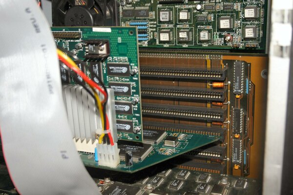

The card sits in a zorro slot giving you 4 pci slots, when you put a card into the pci slot the back plane of the card is approx 4" away from the back of the case! there is a small thin tin bracket that screws the the edge of the card which then extends perfectly to the back of the case and screws to the cases back panel (where your cards screw to the back panel) now this bracket apart from being razor sharp is exactly the right length for a case.
Next is a 3 sided bracket that screws to the Promethous and gives you a back plane support on the card itself and this is where your PCI cards attach, remember these attach 4" away from the actual case so you have to either extend the ports to some blanking plates, create a riser to move the Prometheous 4" closer to the back of the case (also worth noting that the PCI cards sit at 90 degrees to the back plane so you'd have to invert your pci cage) or push your connections through the PCI cage inside the case and attach that way.
I thought it was funny that when they designed this they got the support braket exectly right to the back of the case, so they knew the correct size, but still chose to design the card to be 4" short of the case. in short the card does not fit in a tower, it hits the floppy drive cage in a 4000T and is too tall for a 4000D, smart design huh!

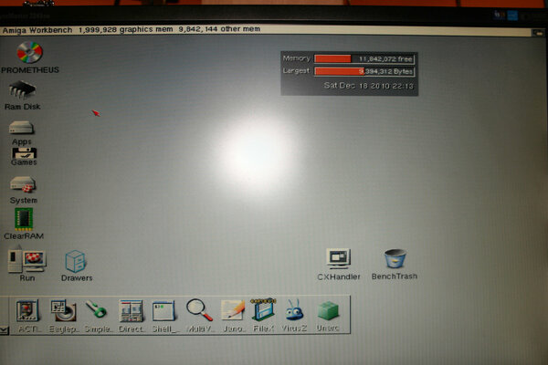

Anyhoo, i installed the cards, then the Promethous drivers, then P96, ran the prefs and attached the voodoo3 to a screen and blow me in about 4 mins the thing worked! 800 x 600 24bit workbench straight off with no messing about.
Next i installed the network card drivers and hey presto that worked too!!
in summary, amazing card, i mean the thing just works! but the actually design sucks the big one:lol:

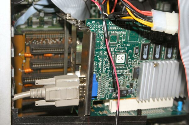

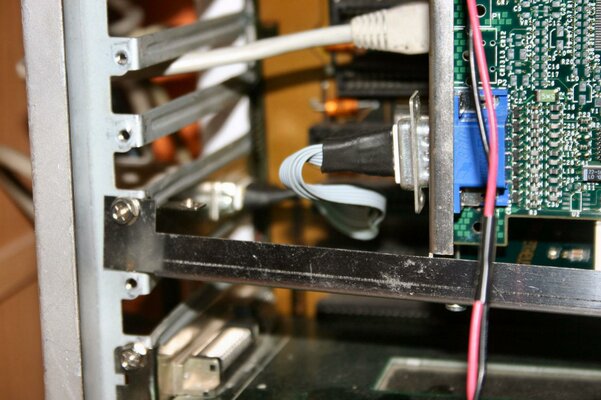

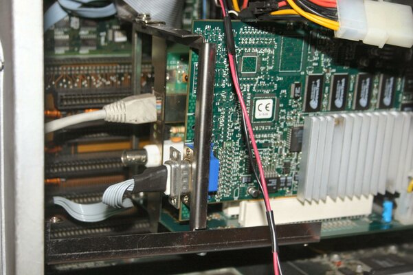

as promised piccies!
please remember this is just chucked together, i hope to fit it all properly this weekend

hi juv that is a bad fitting how dare them design it like that nice you got it going first time tho
Hi Juv
lol yep the design sucks big time but it all works but boy its messy. I had intended to at some point to make an A4000 tower and use that setup but id never get around to it !
You would think that they would of made the pci line up with the tower case better :roll:
anyway have fun :-)

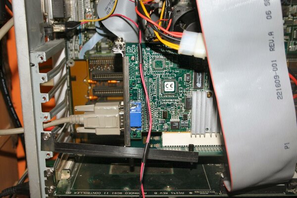

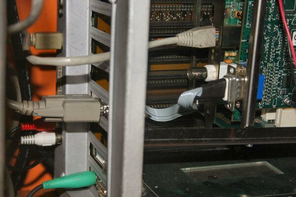

another little update after a tidy up:) and look network activity lights:cool:
and a request, does anyone have or can make or know where to get an ethernet extender? as you can see i don't want to extend it far, something i can mount to a blanking plate

You can probably crimp your own. Pick up some Cat-5, an RJ-45 plug and socket and wedge 'em all together. Assuming you have an Ethernet crimp tool.
If all else fails, I can probably get the bits and make it for you for cost of parts and P&P.
well i don't have a crimping tool, so i may take you up on your kind offer:)

lastest update, look what my good friend GazCBM has made me:)
just stuff the back plane to it and that's the Prometheus all tidy:D
