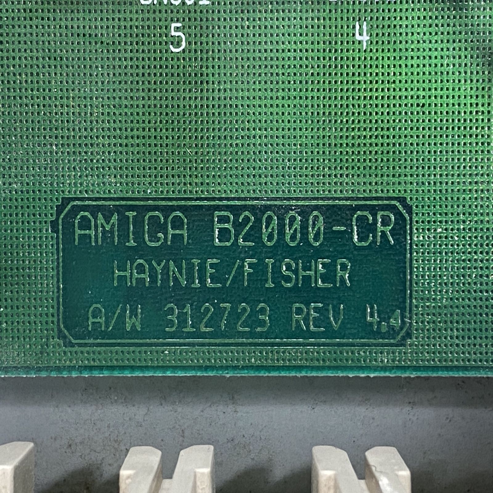

Received day before yesterday, Working Perfect in a A500 REV.6A , fits without Riser. :)
Don`t Work with A2K REV.4.4 , REV.6.2 :(
EDIT:
Working Perfect in a A2000 REV 4.4

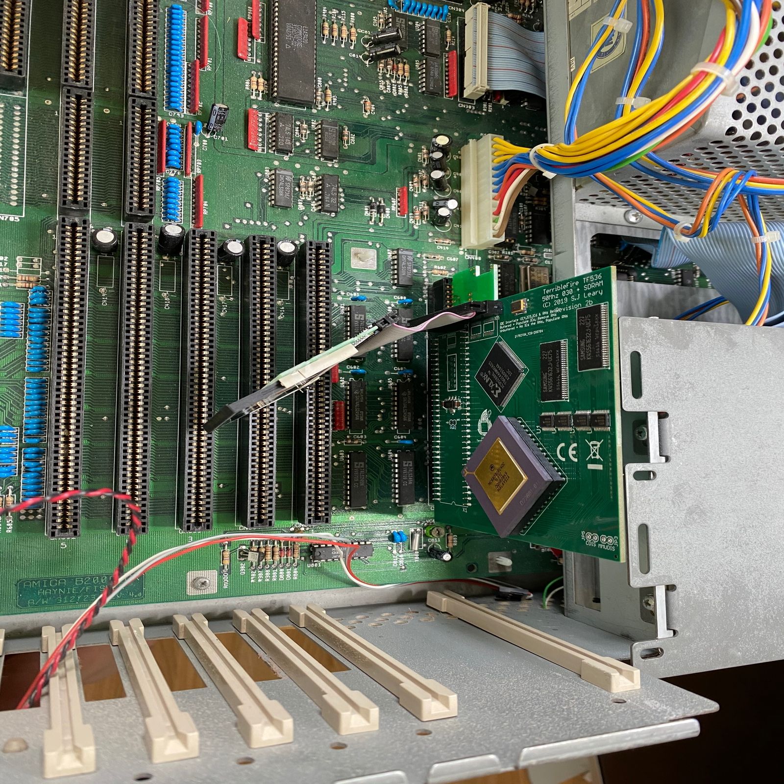

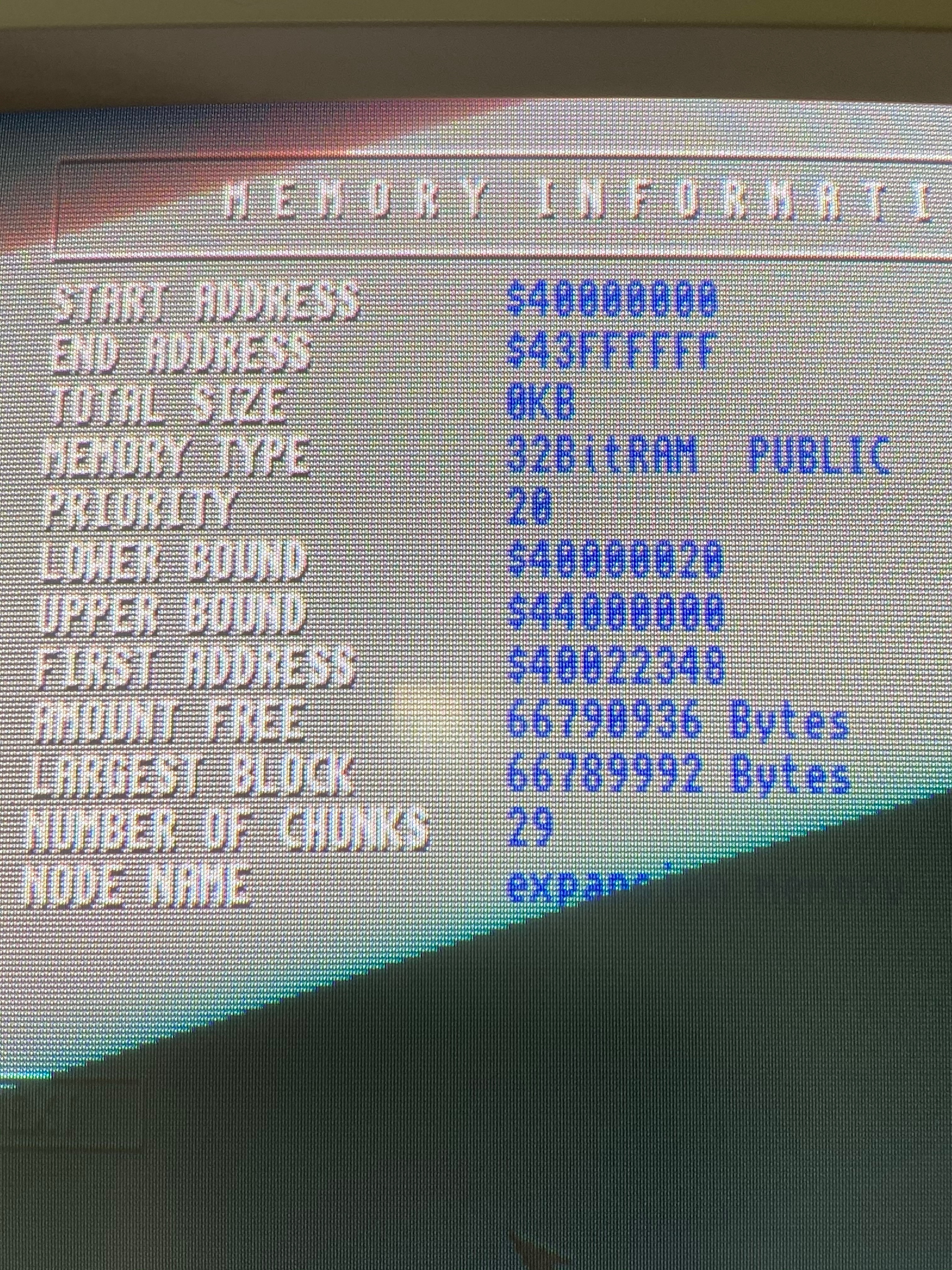

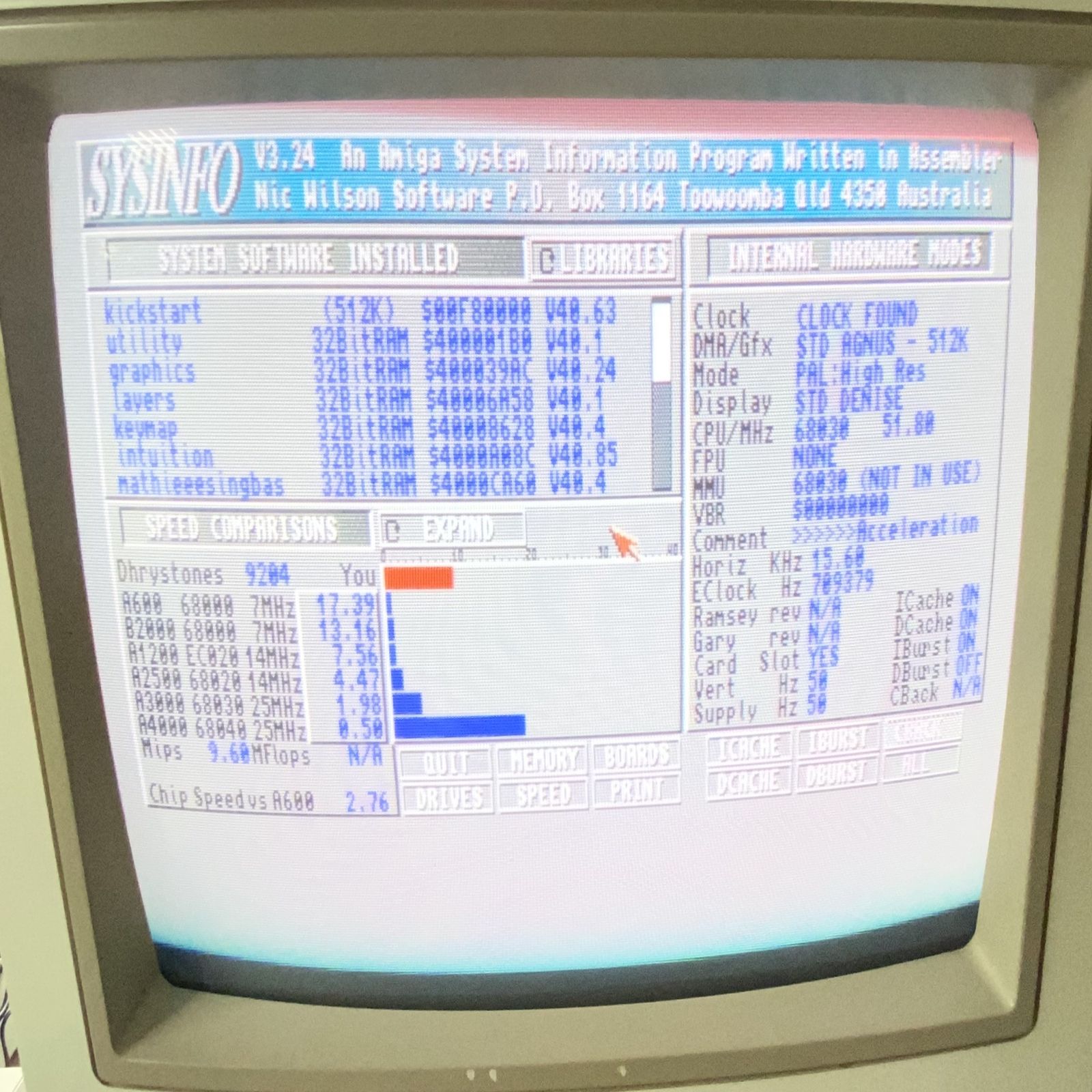

So I thought I would chime in about the A2000 working or not working with the TF-536. Mine works perfectly. Some photos attached.
I have also upgraded my A2000 to 1MB chipmem (https://www.youtube.com/watch?v=z1x3_BoTwg4) by upgrading the 8371 to 8372A and the TF-536 works fine.
@jcm: So, that's some kind of right-angle adapter board for the CPU, and the TF-536 board is attached to that? If so, where did you get the adapter?
