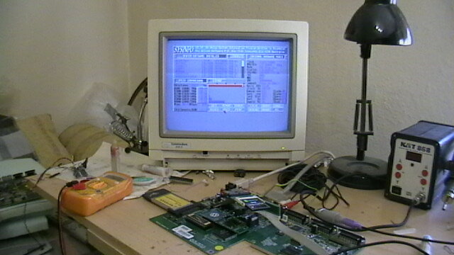

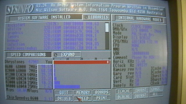

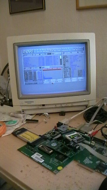

Me on IRC with new card :) Yes, it is working :)
Yes @majsta, I know v1 core is old :-)
Wasnt sure if you were able to fit v2 core into "fake" Cyclone 3.
I expect full v2.x core to totally destroy the 060 in some benchmarks ;-)
@mjnurney we will play a game when time comes, who have top score on sysinfo :)
@eXeler0 I m actually impressed how this "fake" FPGA performs, I m so impressed that I m wondering all the time is it fake at all.
