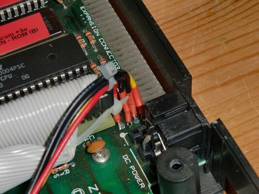

Using Pin 20 for +5v
This is perfectly possible and IF the cf card accepts it you can source this from either the motherboard or the CPU - BUT I will say - please becarefull... these Z80's are 20 years old, as are their ports - I personally dont trust them enough to want to sell them already configured this way.
I would urge anyone on say the +2AB/3 to pull this from the motherboard (it is labeled) - and those with the 48's and 128's to pull the +5 from the regulator
All these will have how-to's over this comming week.
Any chance of some how-to demos? Particularly in relation to pulling power from the motherboard? I notice in one of your original photos, there's a 5v pad under the cable...
If this is what you mean, here's the power from the mobo I did on my +2a.
From left to right it is +5v GND GND +12v
As Zetr0 says, the board is clearly labelled, and you can easily buzz it out from the back of the PSU socket if you're not sure.
And if you look at r0jaws' picture, there's a via connected to the +5V next to the back side of the PSU socket. I soldered a wire there in my +3. A via connected to the ground can be found a bit to the right from the PSU socket if you are looking the motherboard from the front.
