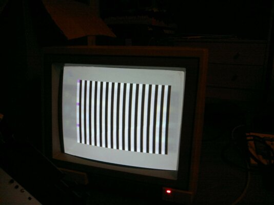

What size of CF cards have you been using with the adapter? I'm having a bit of a trouble with a 4GB Kingston and I'm trying to isolate whether it's the card that's causing it.
Same here, Kingston 4GB

Same here as in you're having trouble with Kingston 4GB or just same here as in Kingston 4GB?![]()
Just bought a 2GB Transcend but I am still having the same kind of symptoms (black and white vertical stripes on screen, when trying to boot).Same here, Kingston 4GB

Same issues, I spoke with zetr0 who has used 2GB cards with success, it may well be that 4 is too big for the current firmware.

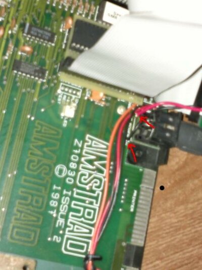

So we'd be better off using a normal length IDE cable? I've been looking for short ones (as used in the Amiga CF-IDE kits but 40-pin rather than 44).Try a normal full length IDE cable & check that all the Pins of the Z80 have seated correctly & the socket pins onto the Mobo socket...
Mine is a prototype handwired but I have noticed noise or 'standing' wave issues with very short cables causing data errors... you could see reflections occouring when I scoped the data bus... I found a 25CM cable run stable and as much as I would like to cut it shorter to test I don't have any 40pin headers left![]()
.....Could someone post pics of their power-wiring (Speccy board to Zetr0's adaptor, preferably on a +3)? I assume I only need 2 wires (+5v and Ground) connected. The motherboard on the +3 is marked but which connectors on the Zetr0 board should these be connected to?
