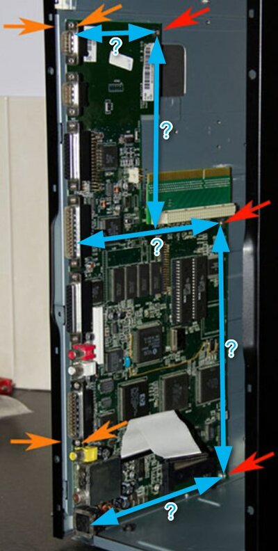

Positions of the holes of the A1200 board
Hello Ed.D,
this is a very nice Tower Project and your rear panel drawings are great.
I also have a renovation project planned for my A1200.
I am therefore looking for the exact positions of the holes of the A1200 board. (see picture attached)
Interest is the distance from the rear panel to the holes and the distance between the holes.
Can you help me.
Regards
Hans
Hi Hans,
Please see page one of the thread. I have uploaded a new JPG image there showing the positions of the fixing centres as requested. Hope it is all ok. I have also replied to your PM.
Kind regards,
Ed.
