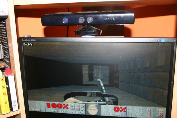

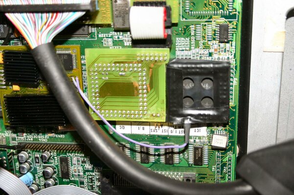

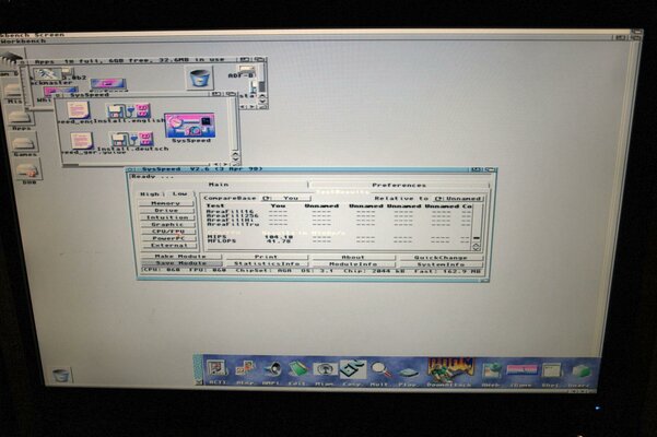

right then, it's still not finished but with thanks to Amigafanboi for the 64 mb of ram and Stan for the 80mhz crystal and Hikey for doing the 1240 to 1260 upgrade i finally have some real speed:thumbsup: (doom occasionally hits 40fps lol)
also a thank you to the community, thank you all so much for your help and input with this A1200, i couldn't have done it without you guys:grouphug::bounceBoingBall::respect::thanks::yourock:

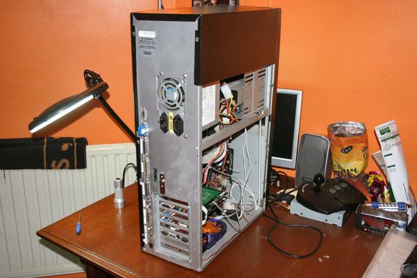

well finally another update
1st off my fast ATA wouldn't sit in place with my SD/FF so a wee bit of filing and now they sit together beautifully:)
next up, i hated the way i had to remove the whole outer case each time i wanted to get inside my Amiga (fnar), so some measuring and cutting later i now have a removable side panel, much better:thumbsup:
and look, no dongles at the back, everything just plugs straight into the appropriate port (I hate dongles hanging out of the back lol)
