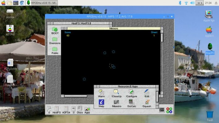

I've been doing some further tinkering with 'my' version of A2PiOS. (shudder... Linux)
-Dumped a bunch of stuff I couldn't see a use for to free up some space (about 1.5gb!)
-Added a RiscOS* emulator: rcpemu...
...for those who haven't known me a while RiscOS based machines are, believe it or not, is my main retro computer interest. For now It's just a basic OS 4.39 install that runs from an icon on the Linux desktop. I'll likely integrate it in to Emulationstation when I've recovered from building it from source.
If anyone's interested let me know and I'll put this update on DropBox.
-screenie-
*IMO: Acorn built some awesome computers back in the day and anyone who thinks RiscOS isn't the best OS ever made needs their head examining, so there! RiscOS will run very well natively on a Raspberry Pi (far, far, better than cruddy old Linux) but as A2Pi and RetroPie need Linux what can you do..?

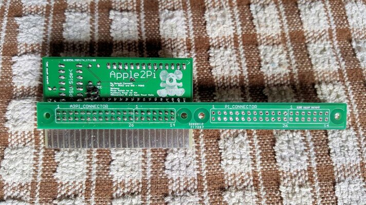

I'm a 'fan' of Seeed
My latest batch of PCB's has arrived. I'm pleased to say Seeed have done another excellent job. What are they for? Oh, they are GPIO extenders, primarily to allow a Pi to be mounted nearer the Apple II keyboard, so making things a little less tight. The PCB's even come with some snappable sections at the end to act as spacers, reinforcers, or an adjustable foot to support the Pi end if required - I've not needed any of these myself.
Pi and A2Pi forever joined
The idea is to allow options. Got a Pi Zero, or not bothered about space? Just mount the Pi direct to the A2Pi board. But if the computer is full of cards my little do-hickey will result in a more Apple II-esque form-factor. Socket or solder front or back; it's all good. In my case I elected to solder the board to the back of the Pi, so leaving the GPIO fully free, and replace the socket on my A2Pi with the extender soldered in place... a bit nerve-wracking as it seem's I'm using my last A2Pi board until I have a reason to order more. It would be typical if I FUBAR'd it.
That looks a little more normal

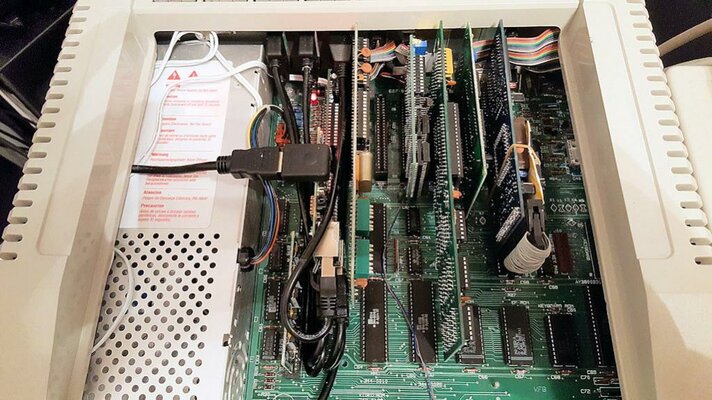

Here my A2Pi+Pi3 is still mounted in slot 1. The mounting is good, the extension cables still reach the ports on the Pi, and there's much more clearance all round... microSD card more easily accessable and no issues with either the 80 column card to the left or the Super Serial card to the right. I think I'd call that a success.

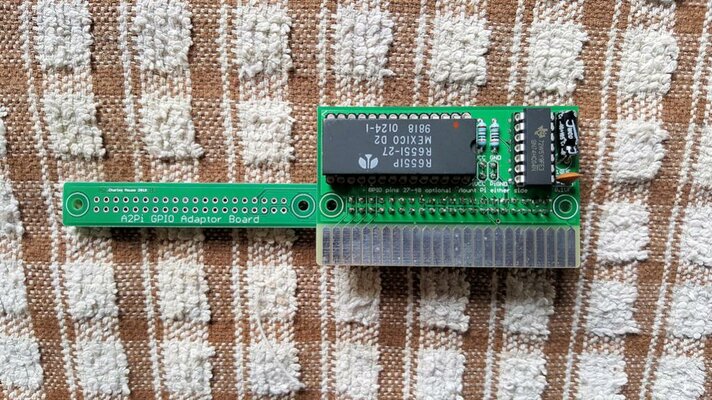

It turns out I had a bunch of my v2 A2Pi boards squirreled away so here's a couple more piccies of a freshly made one, with GPIO adaptor attached:
Fresh as a New Day
