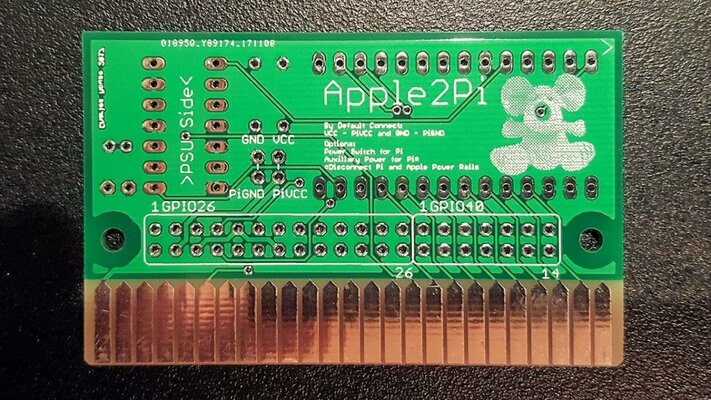

Hi all,
I'm doing another run of these boards as the last lot I made are all gone and they seem to be quite popular.
Small but significant update:
I've added a power jumper block to the A2Pi board. By default the idea is it can be jumpered as per the previous board to get all it's power from the Apple II bus, but now the Pi's power rails can be fully separated from the computer's supply. I did take every precaution to make the jumper settings on the board as obvious as possible as getting them wrong will cause a short, escapes Magic Smoke, flames, FUBAR, etc...
Why?
The A2Pi's electronics are, as before, wired to the Apple II. But this addition gives the option to either add an independent power switch for the Pi or (in the hope that the software may one day become Pi 3 compatible) allow an auxiliary PSU for the Pi to take the strain off the Apple's power rails - I really wouldn't recommend using the Apple II's bus to power a Pi 3 should this ever become an option.
PDF of latest version attached below. :)

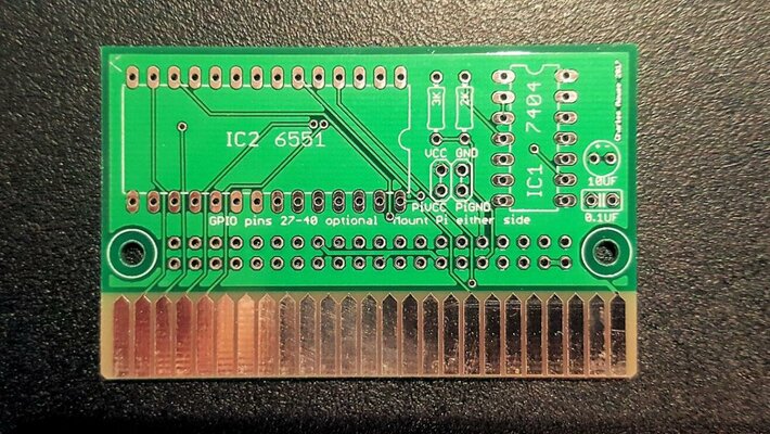

Eagle Files for latest verion below:
Latest A2Pi Revision

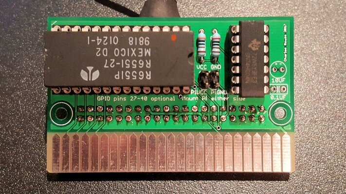

Well my latest boards came from Seeed today, here's hoping I've not stuffed anything up with the latest addition to the layout.
PCB Front and Back

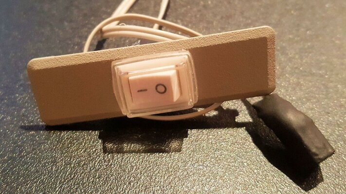

Constructed and Switch
Apart from updating the text so it should now be possible to build an A2Pi with only the PCB to hand by way of instructions the main change was to separate the Pi's power lines from the Apple II by way of a four pin header. Such a useful and simple idea, I wish I'd thought of it sooner. As in the photos above I'm going to use the header for an independent on/off switch but other uses spring to mind...
Time to pull my IIe apart, again, and see if it works - wish me luck!
Very Useful Upgrade my friend. Save having to Pull the A2Pi from the slot if you want to use the machine is Standard Mode..

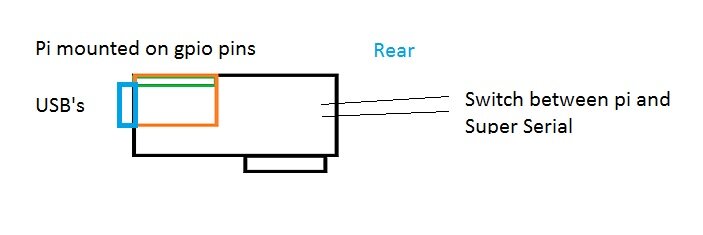

and over on stardot, someone is cloning an apple ii superserial, presumably with the all-important rom
http://stardot.org.uk/forums/viewtopic.php?f=45&t=14496&p=194158&hilit=apple#p194158
Re the serial ic on the a2pi card charlie, is it viable the card behave like a) a super serial and b) have a switchable input /output to a mounted pi? 2 functions, 1 slot?
In a Homer-Simpson-designs-his-perfect-car scenario,:) like this (plus the serial output port)
ps i'll try installing your retropie set up on my pi zero w, over composite.
cheers!
How simple can it be eh:)

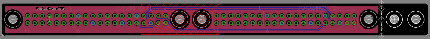

In the meantime I came up with this... hack:
A2Pi Adaptor Board
Imagine your Pi of choice is situated at the keyboard end of the current A2Pi board, rather than on top. The above board intended to be snapped in to two sections; the red part would have two GPIO headers, one that fits on the the Pi and the other fits on to the A2Pi board. The small black bit just goes round the back for support. The whole lot then plugged + screwed together for security. One would end up with an A2Pi solution shaped more like a traditional Apple bus card with a lot more room for manoeuvre...
...this solution would remain compatible with any newer Pi (I need to think about the implications for 26 pin GPIO models) and leave the Pi's GPIO potentially accessible for other modules, assuming no clash with the lines A2Pi uses.
Thoughts?
