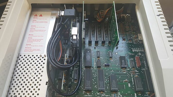

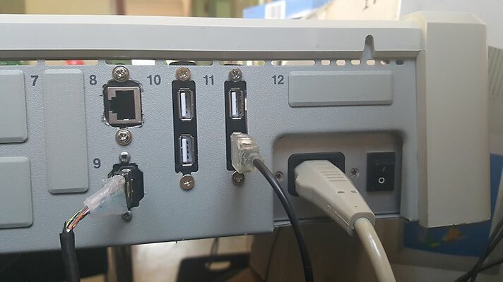

Just in case useful here's a couple of piccies of my A2Pi install in my Apple IIe:
The left photo shows the new external ports. Excuse the scabby HDMI cable, and there's a little more work to do to neaten up the RJ45 cut-out. The right photo shows my A2Pi plus Pi2 inserted in to slot 1. Again excuse the scabby HDMI cable; prior to getting a proper 90deg adaptor I was experimenting with removing the sleeve from the plug, then heating and bending it to fit under the lid... this doses work! Finally I did need to take a craft knife to the HDMI and Ethernet shrouds to allow room for a card in slot 2 with my set-up.
