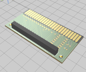

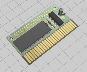

It seems I can't leave Eagle alone! Here's my interpretation of the Apple2Pi board. I feel rather neater than other versions, it should result in a cheaper and more robust solution with better access to the Pi's ports. It should also be compatible with all versions of the Pi with GPIO*
*Direct plugin with securing holes for 40pin GPIO devices
*26pin GPIO devices just need a shorter header soldering in place, no securing holes!
*Apple2Pi doesn't work with the Pi3
Thoughts?
Worth a production run..?
PS
I'll hopefully have a V2 out in a bit. The V1 should work just fine with a Pi Zero but I can see issues fitting the Apple's lid with a larger Pi.

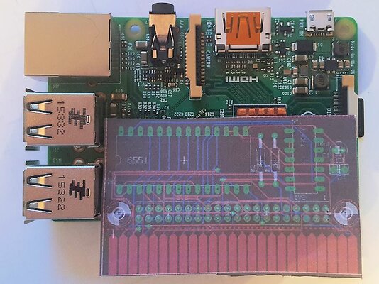

a2pi mockup
a2pi mockup
Getting there?
Below is a scale mockup of my interpretation of the a2pi board 'plugged in' to a Pi 2. This should work with any Pi (except Pi 3) while leaving more than enough room for the ports. A Pi Zero is about the same size as this board, so in effect you'll have the ports peeping round the sides. Older 26pin GPIO Pis will also work, just use a shorter female header on the back.
The .zip file contains .sch .brd and full set of gerber files for anyone interested. Feel free to comment. I'm going to send off an order later this evening so fingers crossed I get some functional boards back.

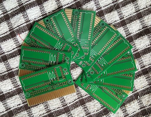

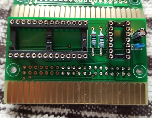

Most kind, thank you. Here's a little something I got in the post today:
I'm now a 'fan' of Seed's 'fab' work
(ahem)
I must say seed did a lovely job, I shall certianly be using them again. Rather excited at this point, especially having never had some proper PCBs made before, so I just had to whip my iron out and give it a waggle. I did this one as a universal version with a 26pin header socket that should allow any Pi to fit.

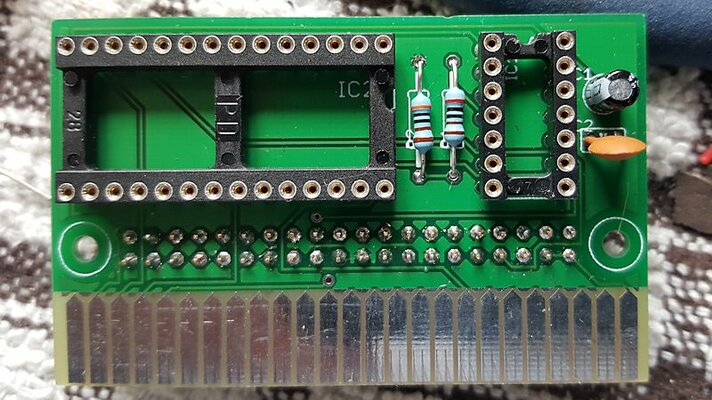

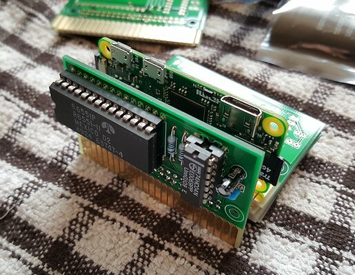

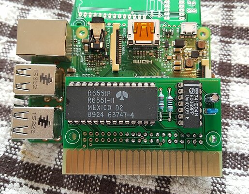

Soldered up and ready for stuffing
Here's a couple of tasty treats to drool over... getting really rather excited indeed. Ooo, which delicious dainty shall I sample first? Nice to see the mounting holes line up perfectly so if one is plugging in to the Pi's GPIO rather than soldering direct it will still be nice 'n secure.
Pi Zero or Pi Fat, the choice is yours
At which point I discovered I'd accidentally overwritten my A2Pi boot disk, Doh! I don't have a serial card, so one VERY slow session with ADTPro later and...
...It didn't work.
Blast!

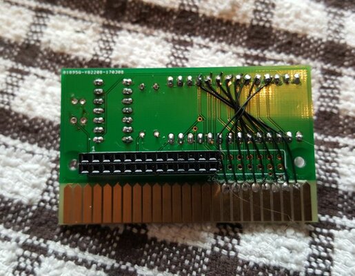

Oh, well... On to the bit I really detest when it comes to making electronic thingamys; tracking down errors. I won't bore too much with the miserable process, just my cry of anguish:
Great Steaming Elephant Turds!!!
:Doh: I'd gone and wired the data bus backwards :Doh:
(Chewbacca)
I believe there is a suitable quote for a time like this: "The path of my life is strewn with cowpats from the devil's own satanic herd." So there you go, ten not very useful coasters...
Actually not as bad as all that, quite salvageable actually. They just won't be as pretty as I hoped once I've cut eight traces and added a little Kynar.

Having fixed the reversed bus on one of my prototype boards, and discovered I'd also forgotten the R/W line for the 6551 *SIGH* I thought I'd give my mounting solution a go. See below:
Fixed and mounted?
Hoppeful that all should now be sorted I gave it another go... But no, just as before: Both Pi and Apple working fine but no communication between the two. Grrr.
So I pulled tthe ICs, put them back in my hand wired board, attached the Pi, and bunded the lot back in to the same slot in my Apple. Yep, still working like a champ. So there's still at least one more error on my board. The thing is I've buzzed it out, looked over my v1 schematic and can't see anything else wrong...

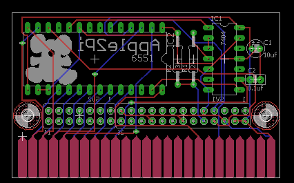

I've now done a v3 schematic and layout which I'd swear is fine but as I still haven't tracked down the remaining problem(s) with the v1 layout I'm feeling rather paranoid.
The attachment below is a .zip file containing my Eagle v3 files along with a .pdf of the original schematic my known working hand wired board was based off.
View attachment a2piv3.zip
Is there a kind soul out there who wwouldn't mind taking a look to see if v3 is indeed ok?
Many thanks.

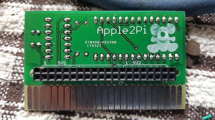

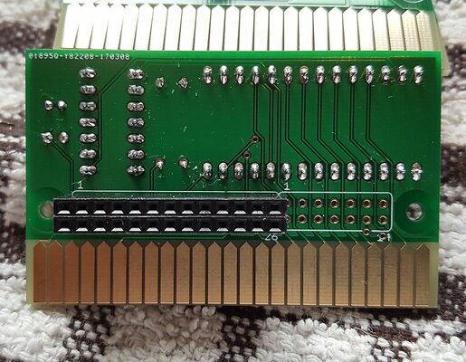

New PCBs back and they do look nice, well done Seeed... piccies in a bit.
Sadly it seems I killed my only 6551 so no testing and no Apple II fun until I get some more. I do hope my new boards work, buzzing it out all seems fine but I still haven't worked out why my Mk1 board (with fixes) won't work.
Apple2Pi v3
Just in case anyone's interested:
Hopefully final version on my interpretation of the Apple2Pi interface board. Not sure why but adding ground planes was messing up the signals so I decided to do without... my hand-wired board works fine without so I just deleted the offending bits.

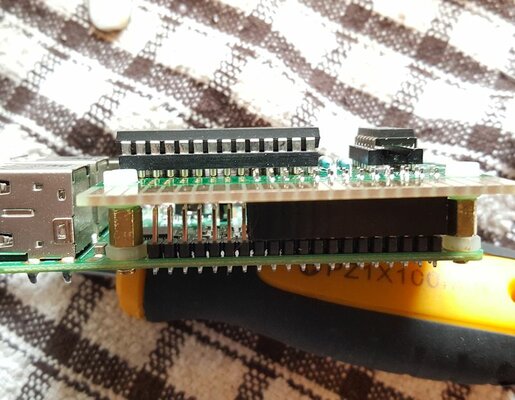

The catch is it only boots right one in 5 or so, and only if moved to slot 1. I think I'm going to have to eat my words about the Apple being so slow one doesn't have to worry about cross talk...
...in an effort to keep the board as small and cheap as possible the GPIO pins run very close to any open slot lower than the one the board is plugged in to. I guess moving it to slot 1 reduces that interference a bit. I therefore assume the remaining issue with the board only starting occasionally (again done to reduce size) is that the 6511s IO lines cross the GPIO causing another source if interference. I thought I'd been really cleaver assuming the bus was too slow for cross talk to be an issue.
I'll test my theory by gluing some insulated foil to the back of the GPIO header (and same for the Pi). If that fixes the slot issue I can always hope it also fixes the remaining stability problem. If not I'll have to do a board more like the original but as that's a much bigger beast it will cost more and it does offend the eye to see so much PCB space unused.
