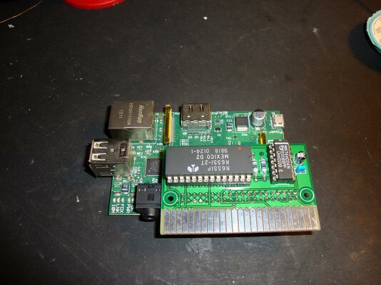

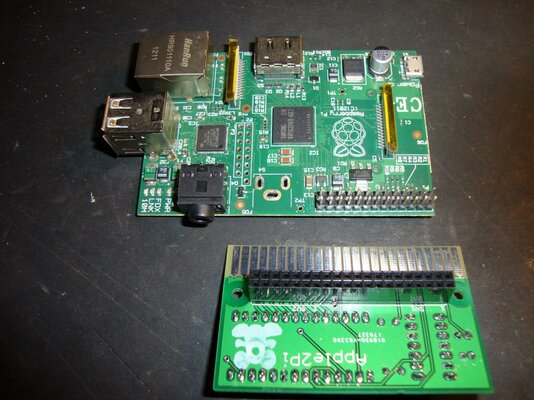

And so it begins.. Pins 1 to 26 are the same on ALL Pi models, the newer ones just have extra Pins 27 to 40:)
To use a Pi1 you will need to remove the composite connector, but attaching direct connection for a rear Apple mounted Composite socket is easily done :)
Advise you chop down the pins on P2 or remove the complete header as movement of the Pi1 will cause a short circuit between P2 and the Interface board.
See the Piccys.... Right Linux Time :)

Glad you're having fun chaps. Yes, maybe I could have made it more obvious which way round the board goes.
To confirm:
1) Plug Pi in to board such that A2Pi edge connector is down and Pi up... It should be obvious with a 40pin GPIO Pi, take a careful look at the markings on the header for a 26pin GPIO Pi... in Iain's case I deliberately omitted the redundant pins for a 26pin Pi - just cut off the redundant end of the connector if using an older Pi and hopefully good to go. (See photos further up thread)
2) Plug combination in to whatever slot you like. With the Apple's keyboard facing you the Pi should be on the left, nearest the PSU, the A2Pi board to the right. It's obvious with a full size Pi, but less so with a Zero. Personally I'd stick the combination in slot 1 or 7 to allow fullest room for connections but it should fit in any slot as long as any card in the lower slot is not too bulky.
